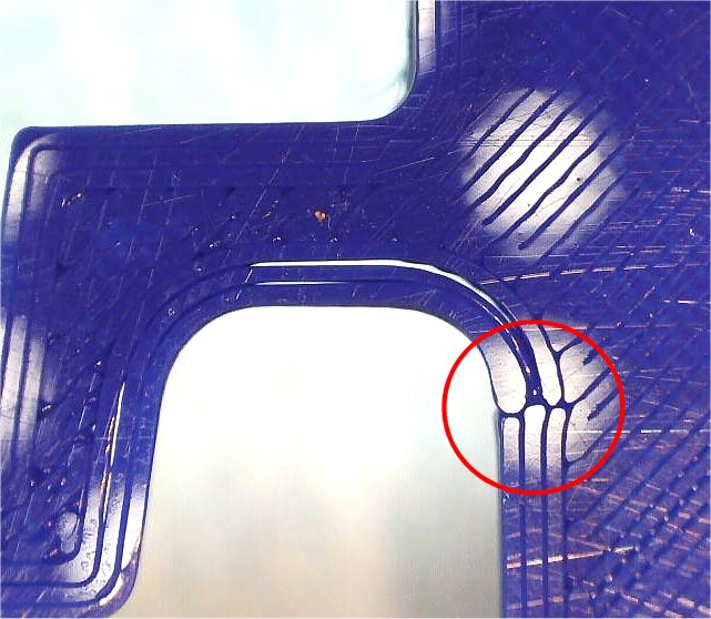

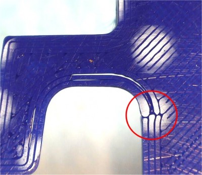

Thanks! I don't think getting the first layer down is the issue, but I went to take a picture of the bottom, and I made a discovery (or two...).
Here's what the bottom of the print looks like:
The filament looks like it's sticking down OK, but what I noticed is that the underextrusion & gap are occurring immediately after the start of the 2nd perimeter pass!

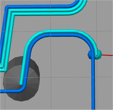

I went into Preview, flipped the model over, and examined the same area:
Gaps Previewed From Below.jpg (18.57 KiB) Viewed 13873 times
The first perimeter occurs normally, with the nozzle going counterclockwise around the opening. At the end, it jumps right and begins the 2nd perimeter. There is a retraction at the start of the 2nd pass, but it's acting like it isn't "unretracting" when it starts printing again, and the nozzle is starved for filament for a significant distance. The third pass starts in the same fashion, and may also be starved for filament.
Not sure what exactly what this means or how to fix it, but the gaps are occurring because the extruder isn't pushing enough filament out once it starts the second (and probably 3rd) perimeter.

Very interesting. Were there other places on the 1st layer where retractions / immediate restarts occurred to compare with?
And you have 0.2mm of "retraction vertical lift" enabled. Can imagine if the printer had a sticky Z axis /backlash it might not come down again as promptly as the Z axis movement speed of 20mm/s would suggest.
