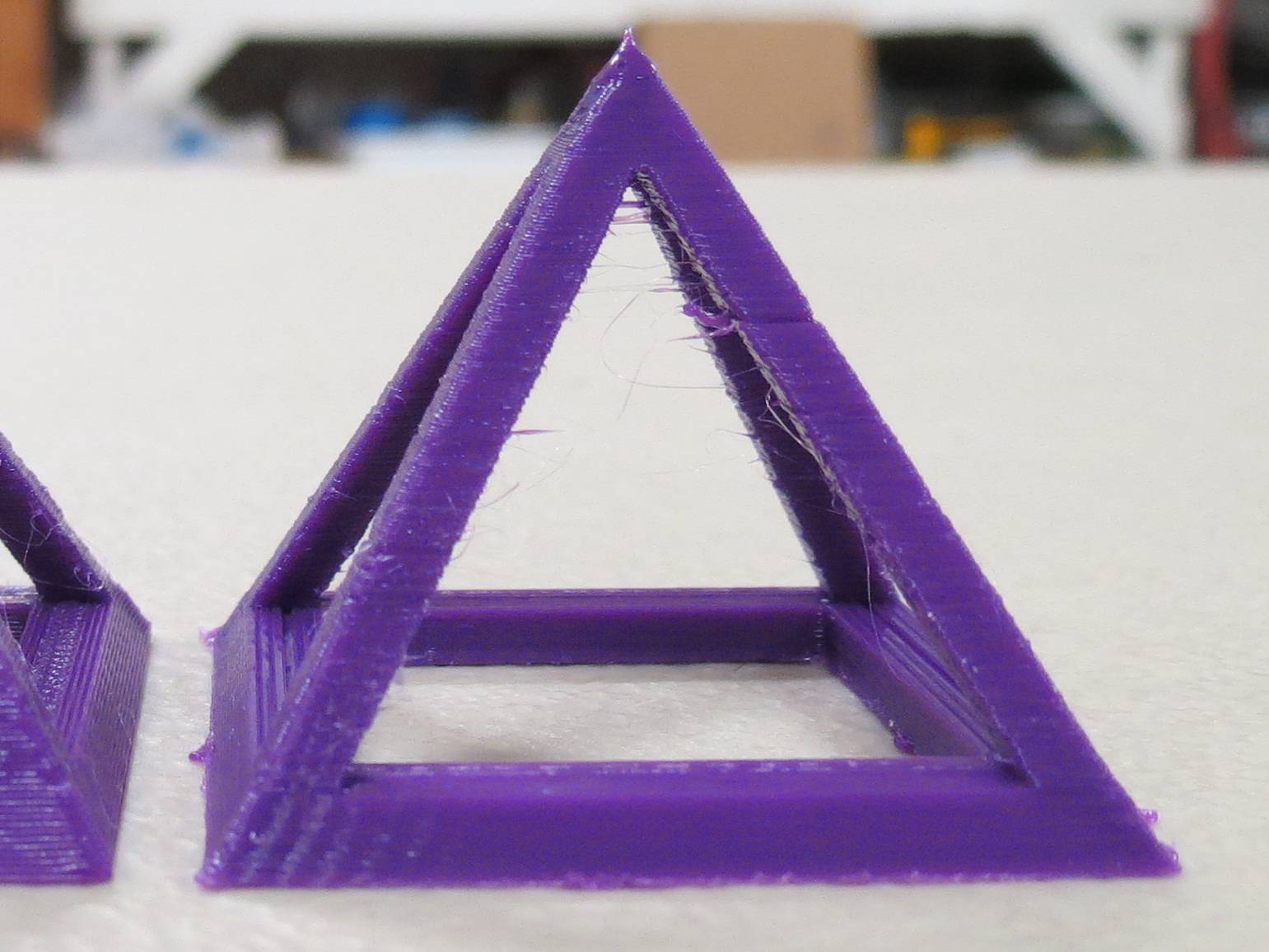

OK, here is my attempt with a new factory built M2, and the complimentary purple PLA. The left is default medium (0.25mm) resolution, and right is default high (0.15mm). I think the only thing I've changed is to 4 outer layers, instead of 3, and some of the gcode script.

It seems that you are also getting pretty much the same result.
I am not glad that it came out this way but I feel better cause it's not only me.

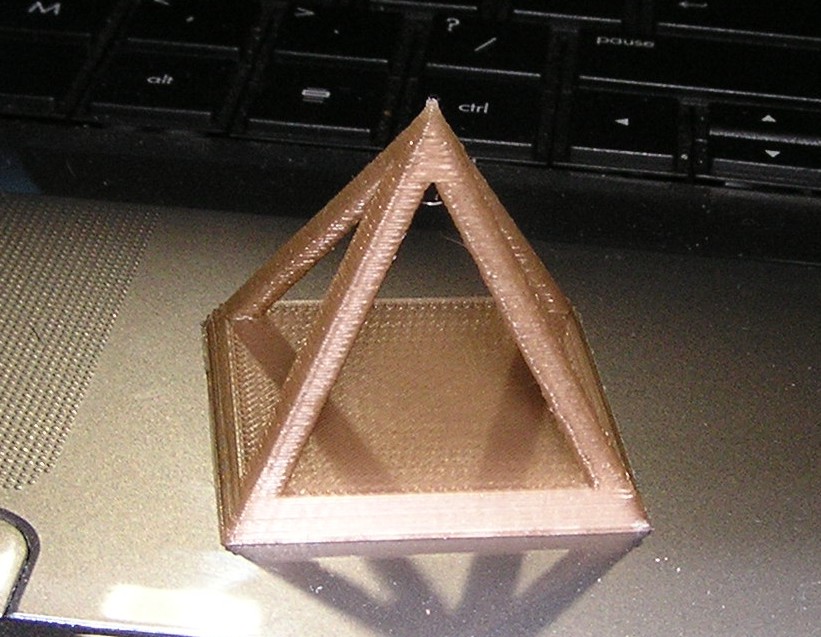

Posted: Mon Jun 10, 2013 8:16 pm
by slipshine
It definately looks like you are printing to hot. Good job on testing the hot end.
When I was trying to print test pyramids I went through a couple of issues as well.
You might want to check out :
http://forum.simplify3d.com/viewtopic.php?f=8&t=109
I think your on the right track.
