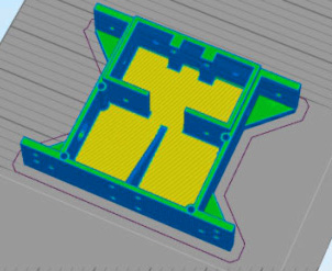

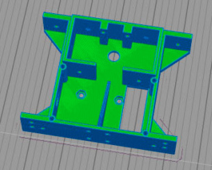

Here are my examples. It strongly suggests something in the layer heights is unhappy.
Using S3D 3.2 on a printer-dedicated 5ish year old Mac Mini using OS 10.6.8. No other software installed except stock Apple software, S3D, and Google Drive. Never had a problem with this until version 3.
.2500 layer height
.2500 layer height
.2000 layer height is the only change I made

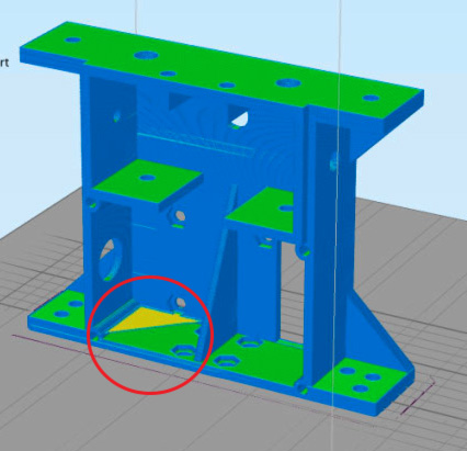

This one is .2000 height rotated. I did not include a 2nd "fixed" pic, but when I switch the rotated model to .2500 layer height the bridge disappears. :roll:
Re: Printing bridge over the hole
Pictures only are not enough for issue investigation. Please post the factory files for these two parts. Then if S3D support need any evidence, they can use the data...
