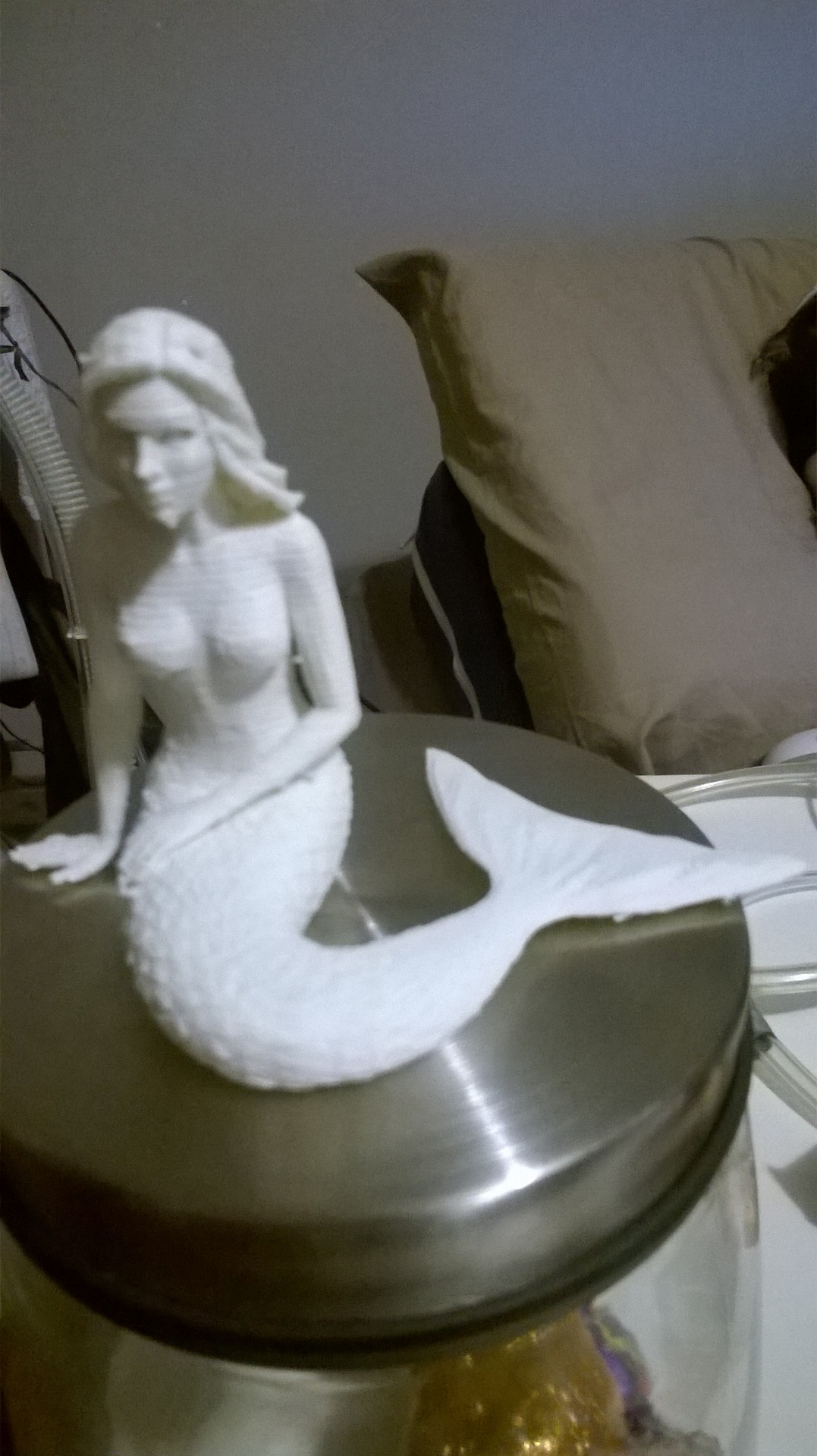

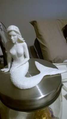

I printed it with 20% infill and it turned out brilliant just gotta smooth it now
