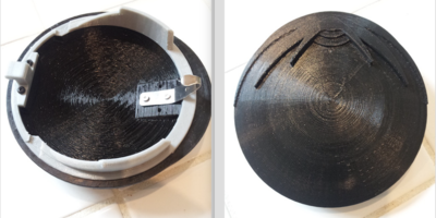

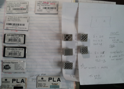

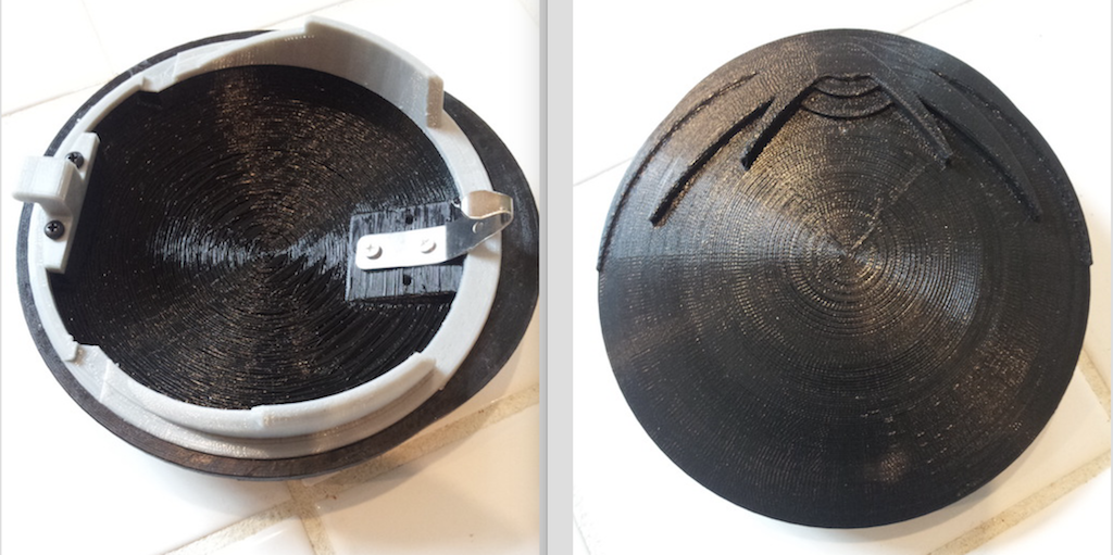

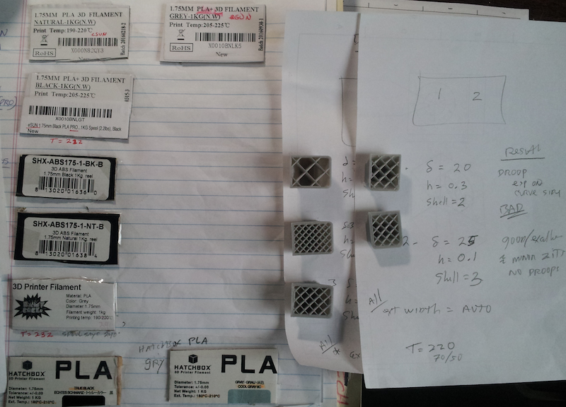

Regardless of recommended Temp, I use Temps from the testing I do, not from what is printed. I imagine (I hope) those reading my post’s apply commonsense and, hopefully, do some testing to dial-in what works for them, their material, their printer and parts. Notice that 'infill' as well as other parameters affect results...
Attached part is helpful to dial-in overhang curved surfaces…
Referring to Motorcycle, this Lid is for my Harley’s gas tank - it is PLA and printed at 240ºC with sparsely distributed support (the support spacing was 5mm)
good luck
Oh, regarding experience: I'm a degreed Engineer with 48 yrs experience, several patents, stuff flying in space and parts in human bodies. Hence' 'Greybeard' though, it's been white for 30 yrs!
