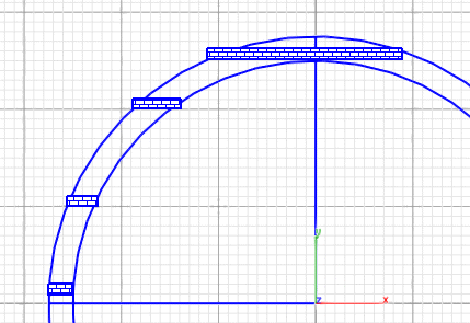

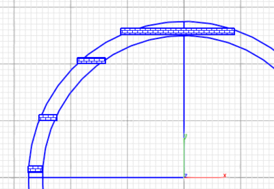

First, I show some pictures of a sphere to be print.
There are many many possibility for settings, I limite it to only 2 perimters, with and without Infill and one example with 2 prcesses.
There we go,

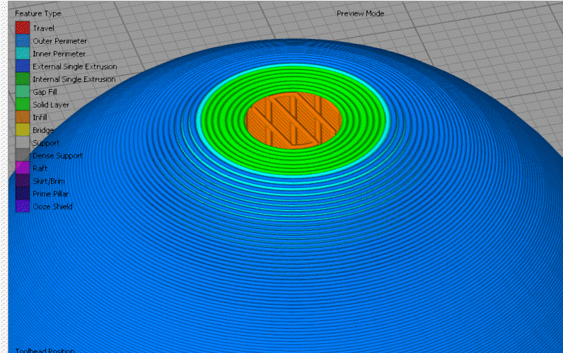

a sphere with infill makes normally no problems

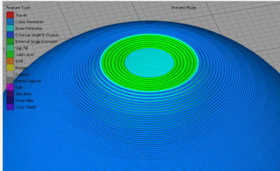

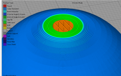

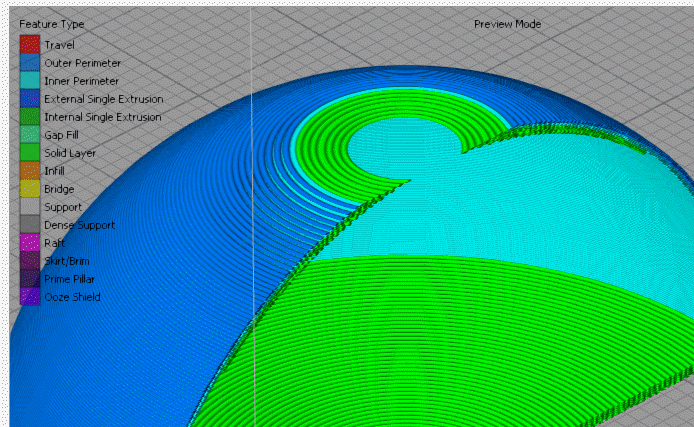

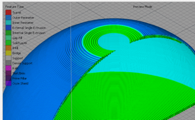

totally different to this is a sphere, it is not or only with absolute bad quality to close on the top

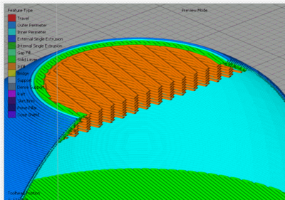

You can see, the last Millimeters of the top, the perimters and the solid infill have no substructure below. Zhe printer would print the material in the pleine air.

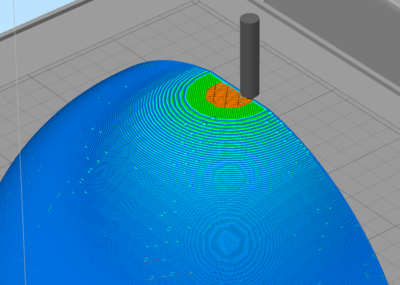

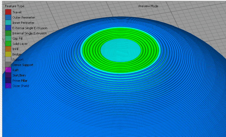

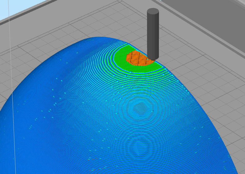

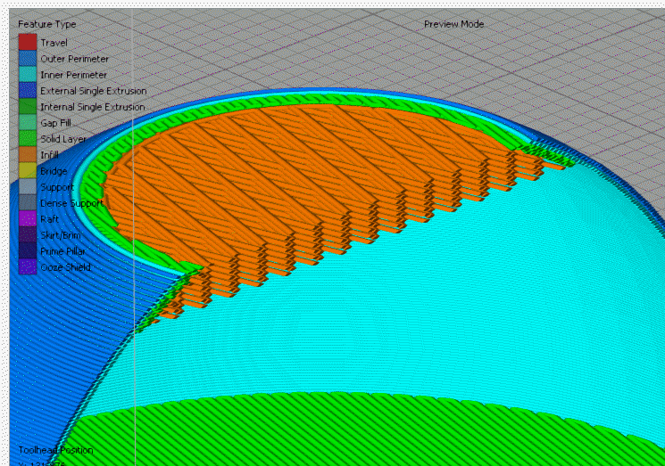

At the end here the sphere with 2 prozesses, the 2nd beginns 5 mm below the top. It needs to set the solid infill to Rectlinear.
Inside of a hollow body S3D doesn't print any bottom or top layers so that the infill of the 2nd process must be bounded to the outside wall, a sufficient overlap is needed.
A visual control of the complete print preview is obligatory, but testprints are not to replaced by any other action.

Here the rest

Thanks so much. My actual model is actually a half bowl (factory file attached). And really it's the last 3 or 4 layers that are causing the problem where the hole is showing through the PETG. It sure seems like maybe in my case the easiest solution is to have the last 10 layers have 100% infill that way the walls of the bowl at that point are totally solid such that when the last 3 layers go really quickly and don't completely cover what is below, then what is below is solid infill not infill which naturally has holes...

Of course, now that I think about it, just increasing the "top solid layers" from it's current value of 3 to something like 10 or 20 would do the same thing :)

The problem is determined by the system of 3D-printing: Layer by layer
While the LayerHeight is fixed, the real LayerWidth groves up and becomes extremly to cover the expanse.
I believe this is only to solve when it is possible to print real bridges by the choice of the users and not only by an algorithme of the program. If we can do so, it will be much better.
Splitting into processes helps but inside a body we cannot print any top or bottom layer what can serve as a bridge.
The preview of the print shows holes but in reality they are not existing. Thats because the preview differentiate between the kinds of inner-outer perimeters, solid infill, infill but this is normally always the same material what makes the optical impression. The surface will always be a bit coarse, but that is also a systematical problem. Printing with ABS or ASA you can smooth it with aceton.
