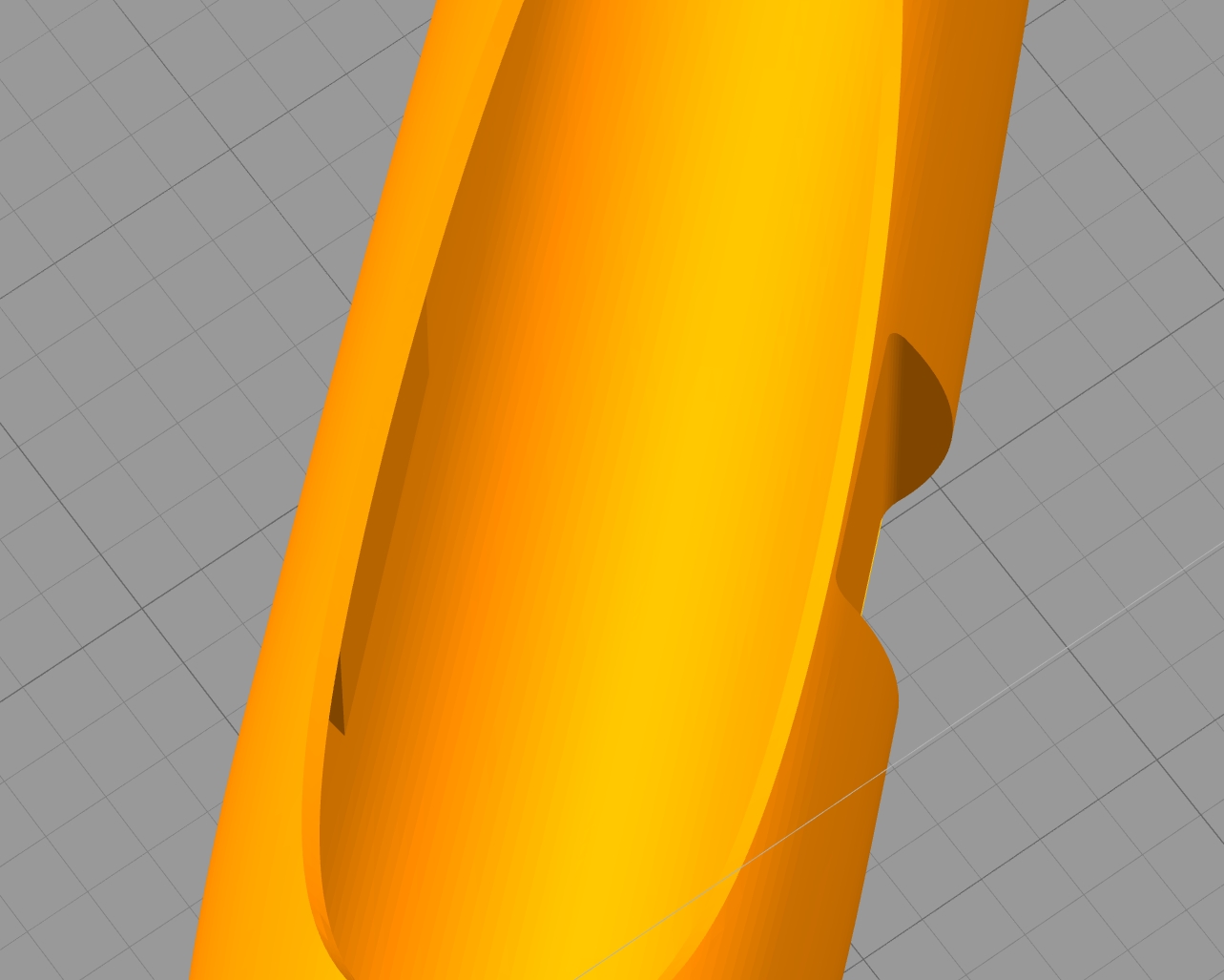

@ Greybeard: Thanks, I was looking in the simplify software for the acceleration/jerk. It is a prusa i3mk3 , so I will dig into the settings on the machine itself. Yesterday I did a tril with a bit slower settings (3500mm/min) and it look quite Ok, I can use these forms finally. The only issue is the top.
Everything looks fine , except for the very top part , it looks like the bridge/gap is a bit too big. I tried to play a little bit with the bridge settings , but it doesn't seem to do anything. Any pointers how I can make the top better ( from the first picture)?
Thanks,
Cor

First - review Simplify’s print quality guide for tip’s and solutions to common problems.
Second - settings for quality prints are inter-related with respect to outcome. To solve quality problems, it’s all about trial and error. Infill, Outline overlap, Infill pattern and density, Temp, Number of Top Layers…. etc… etc… And, of course, material type...
For a problem such as the final top surface, I would do this:
Sink the part into the bed so only the top section will print (but, ensure it’s above the lower layers where the speed is slowed by the software). You should see the same problem. Now, you can test various settings without wasting too much time and filament.
Lastly, just because the car speedometer indicates 140MPH, doesn’t mean you should drive 140MPH (sorry).
Print machines are rated for the Speed of Head travel, not the speed of Printing (melting and pumping out filament).
Aside from the settings, type of filament, brand, color (especially white)… all play a role and the manufacturer has no idea of what you’ll use or print…
You’re almost there!

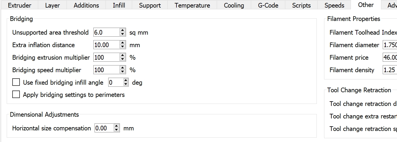

It took me a while how to sink the model , but I found it, and could now more easily play with bridge settings:
I think the outcome will be better like this. Next week when I will be home again I will try this.
*edit* , someone tipped me about changing the "top solid layers" , now it is 3 , more should sove this problem as well
I will also try to print this with Petg , reading on that it says , this will be easier , and also good enough for outside temperatures in the sun.
Would it be possible to print this in 1 go ( not in half like I did yesterday) since I understand it is almost impossible to glue Petg parts together.
What I am worries about is the bottom again, which rest on the supports , that it is not smooth enough.
Cor

The only reason I use Simplify (versus Slic3r) is for it’s ability to add and delete supports where I want and how I want. Great feature!
For your part, you can Add supports in the support pop-up and place them (with the mouse) where you want (most likely under the top where its flatter). See tutorials.
You can set the support size dimensions/spacing/angles…etc and I suggest some playing around to fully understand it so as to be able to do what you want without too much trouble.
Yes, you got the idea of sinking.

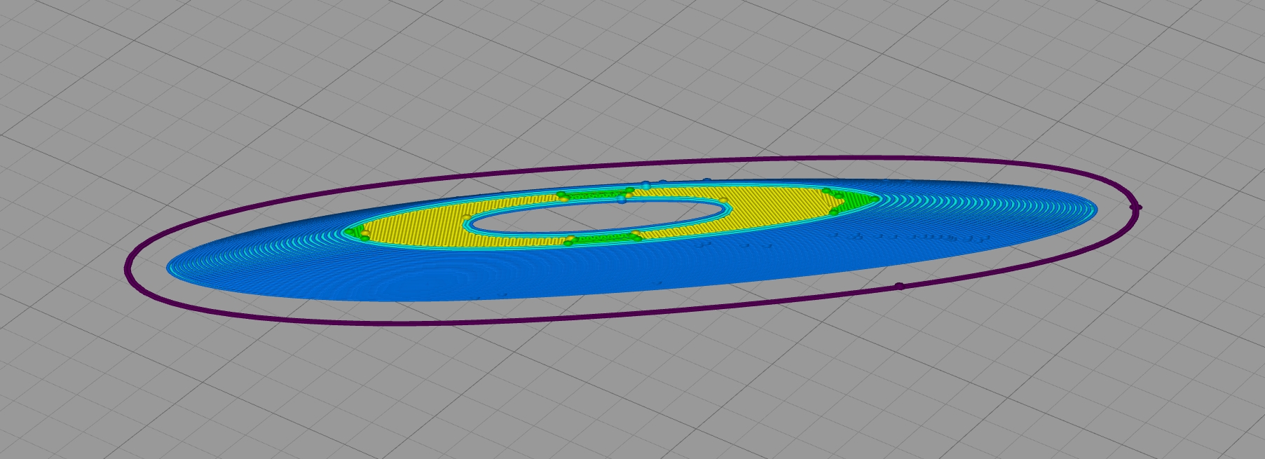

Have been playing a bit with the programm the last couple of days and a question.
I have drawn a thicker part :
When I slice it , it kinda looks it is a seperate part, which it is offcource. But will is be bonded with the rest of the wheelpant , or will it not be a part which is attached firmly?
How would I optimize this?
Many thanks,
Cor

Posted: Wed Jul 11, 2018 4:38 pm
by dkightley
Use the Separate Connected Surface option on the Mesh dropdown. You're now suffering from multiple meshes...which fortunately is not terminal!

by Cor
Yep , awesome. The wording "seperate connected surface" wasn't very clear . I wanted the surfaces to bond together , not to seperate ...... but it does exactly what you promise.
