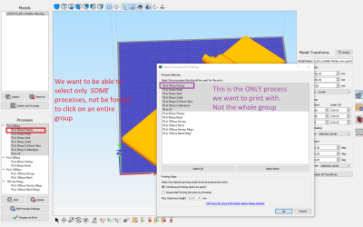

This is not fixed, and it does not behave like before. It was only half-way reverted. Please see screenshot below. We can still not use this software as-is.
process selection not fixed

by S3D-Jason
The old V4 behavior was to use the same selected processes when the print dialog is shown. That's how it's currently working in 5.0.1 as well. If you want to suggest selecting a subset of the selected processes by default, I would suggest making a new feature request since that's a different behavior and we would want to see how many other users agree with the change.
