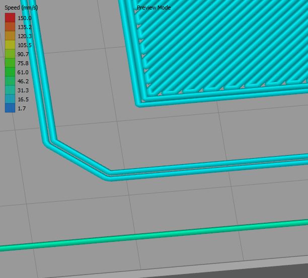

I made some investigation about this because i also think that the speed of the Skirt/Brim shouuld be more controlable.
Let´s start with the "other" tab in the FFF settings:
Default Printing Speed 60mm/s.
For testing Outline Underspeed, Solid Infill Underspeed and support Structure Underspeed is set to 100%.
"Layer" Tab:
First Layer Speed 35%.
Working as expected the first layer including the Brim is 21mm/s.
If you set the parameters in the "other" tab as follows:
Outline Underspeed 50%, Solid Infill Underspeed 80% and support Structure Underspeed 80%, you get the following:
Now the first layer of the object gets printed slower as the Brim because the Brim is handled neither as an Outline nor an Infill.
So one solution would be to handle the Brim as one of these or make the first layer independent of the "other" tab.
Strange things happen if you use the Raft.
With the same settings as the pic above you see that the first Object layer is printed faster than the last Raft layer and ignores completely the "other" tab. The second object layer is printed with the "other" tab taken into account.
This behaviour is not clear to me and seems like a Bug.
Other things i noted:
Why is the Printing Speed Legend not automatically adjusted to the max printing speed? Max speed is 60mm/s, but it´s showing values up to 150mm/s which is never reached.
The first line to get the filament flow started, just before the Brim, is printed faster than the first layer settings. This should also obey the first layer settings.
Version 3.1.0
BR RR
