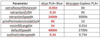

Here's the really condensed version of the differences I think may be involved

Test 2A was Airscapes's gapless process, with three settings imported from my gappy process:
extraRestartDistance = -0.05
retractionZLift = 0.2
retractionSpeed = 2400
There is one section of the inner perimeters that shows a small narrow gap. Viewed from the bottom, the start of all three perimeter passes looks consistent in width. Basically, something in these three settings is causing a gap, but it's much better than before.
Test 2B started with Airscapes's process again, but with the four remaining settings imported from my gappy process:
printPerimetersInsideOut = 0
minInfillLength = 5
defaultSpeed = 4000
outlineUnderspeed = 0.3
This configuration did NOT have any gaps, but if you look on the bottom, the start of the 2nd perimeter pass looks starved for filament.
It appears that the large multiple gaps I was seeing are not the result of a single setting. I think it's a combination of whatever is producing the small gaps in Test 2A, and whatever setting(s) are causing the underextrusion at the start of the 2nd perimeter in Test 2B. Put those two together, and you have a problem.

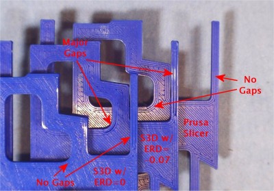

Well, there's more to the story. Once I went back to a larger version of my model, I discovered that without a small negative Extra Restart Distance (ERD), I was getting "zits" on the faces of some dovetails I'm using to built a larger overall structure. I could clean them up by hand, but that is going to be very tedious. I can get rid of most of he zits with an ERD = -0.07 mm, but as soon as I do that, I get gaps in the perimeters again, despite all of the other changes. ERD's around -0.01 or -0.02 don't have a noticeable effect, but by the time I get up to -0.07, the gaps are are quite evident, and appear to be the result of under extrusion.
I really think this is a bug inS3D. The ERD should only affect a very small effect at the beginning of a perimeter pass. I'm seeing under extrusion that lasts for many mm, and in some cases, almost a cm.
I tried the test models in PrusaSlicer, and without any tuning of the settings, I get prints with no zits & no gaps.
Here is a comparison of the S3D processes with ERD=0, ERD=-0.07, and Prusa Slicer ("PS"). The first shows the zits I was getting on the dovetails:
And here is a comparison of the test file where I get the gaps:
PrusaSlicer doesn't have as many options for fine-tuning things, but their default algorithms seem to work remarkably well. The one thin arm where S3D tries to use 3 extrusions to make a 1.5 mm wide wall with a 0.40 mm extrusion width, PrusaSlicers sensibly does it with 4.
I'm going to report this to Tech Support, but for now, I have no choice but to switch to using PrusaSlicer. I don't like many aspects of the user interface and the way they store printing parameters in a bunch of separate places, but if it's the only way I can get quality prints, I will have to learn to live with it. Of course, if this is a bug, I can't expect S3D to ever fix it, given their track record on updates for the last 2 years...
