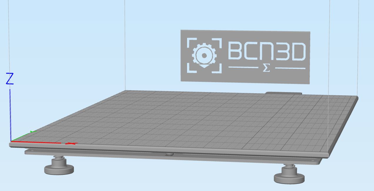

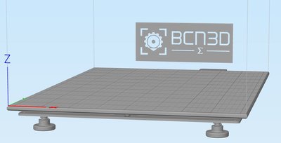

I have modified the BCN3D printbed model from the cura version to be used for S3D.
With the modified STL the visualisation looks like "inside the BCN3D Sigma".
You need to select the STL in the S3D menu like this:
Tools => Options => Machine (Printer Models => Add << select STL >> )
bcn3dsigma_platform_S3D_logo4.zip
(1.56 MiB) Downloaded 536 times
