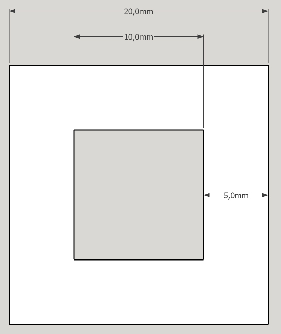

I made a test cube, 20mm x 20mm x 5mm high.
Inside this cube I made a 5mm square hole, and next to it a 5mm diameter hole.
I purposely set the extruder to over-extrude a bit, and also started a print a little too high off the bed. Why? So that the holes would be cone shaped - not in G code, but because of the nozzle. A slight over extrude, and a starting the print a hair too high off the bed would make the holes wider at the bottom (not flattening out against the bed as much) and narrower at the top (over extruding on the top few layers will cause some "smushing")
