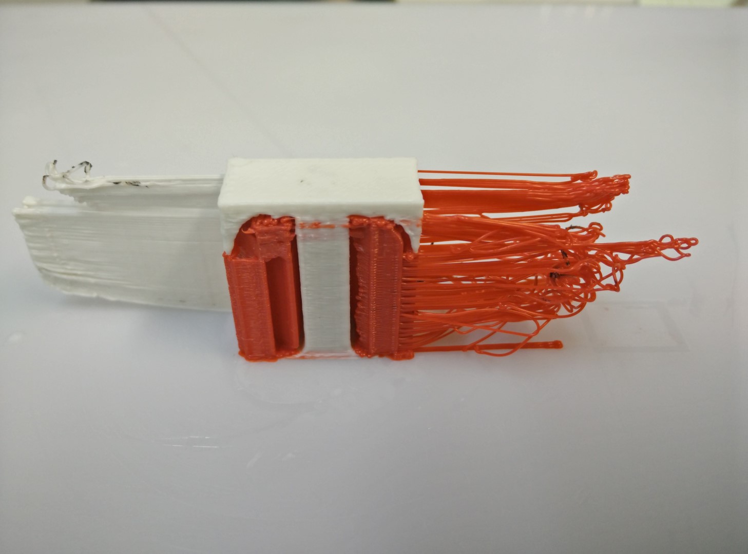

I tried multi color prints, but the results where bad (like here download/file.php?id=1337&mode=view).
The printer extrudes when it shouldn't....

We finally conquered that issue just before 3.0 was released--i'm not at the office now, so I don't have the FFF files to fix it. The issue is that the *&%&*^ CubePro doesn't actually change tools unless it is extruding, so when it performs the offset, it extrudes while it is doing so. Since Simplify went to 3.0, you may not need the FFF files after all.
Try adding a priming pillar (in the ADDITIONS tab). That may (although I haven't tried it) fix your problem--it will mean the pillar gets all the extra filament and not your part.

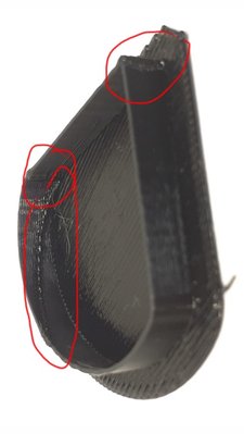

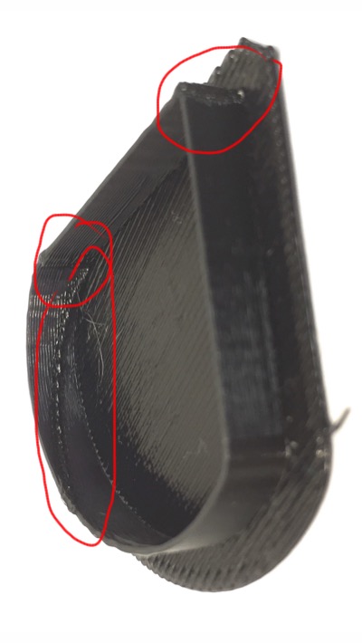

Okay, I've made some progress now I'm a bit stuck with something I feel everyone has encountered.
I got simplify 3d Dialed in almost.. I have a layer thickness I'm very happy with, now I have these seam issues that I can't figure out how to get rid of.
I've tried multiple ooze settings in Simplify 3D but I'm getting no where... I'm closer than ever before. Hope someone here can help.
Thanks,
Here are some pics, I circled the seam issues.

the_dude wrote:Okay, I've made some progress now I'm a bit stuck with something I feel everyone has encountered.
Thanks,
It looks like your seam issues are due to start points and accelerations, rather than ooze control. The Cubepro must extrude at a constant rate, but the moves aren't necessarily a constant speed. As a result, you will get visible seams whenever the layer starts, and you will see corners bulging. There are acceleration parameters you can hard-code into the g-code. I don't remember which lines in the start script control this--perhaps someone out there does!?
(it may be the M240 SXXXX line. mine is set at 1400, but this is probably much lower than you want)
Our cubepro has been down for a while and I'm not sure we're going to invest in fixing it. I'm lobbying for getting a different printer--we may gut the electronics, but that burns a lot of expensive engineering hours(mine).
Anyway--You will want to decrease the travel speed and increase the acceleration. (and also decrease the flow-rate).
This is a difficult problem to solve with this printer, but it shows up far worse on calibration and fine-tuning prints than it does on real-world prints.

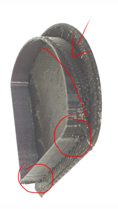

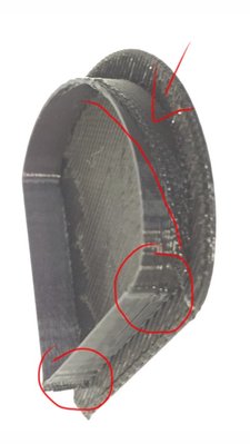

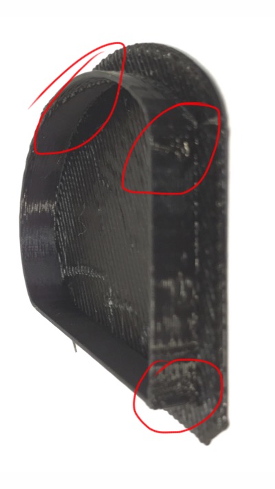

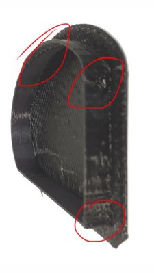

Today progress:
After trying a bit more settings.. I finally tried messing with the code.. I adjusted M108 S27 to S17 and like magic, the larger seams disappeared.
What didn't go away was the angular seam along the curve side. So I tried a bunch of other settings again with no luck.
Finally I decided to test out the infill.. and like the previous poster said, the seam went away.. well almost.
The angular seam is not gone, but a vertical seam appeared further along the curved side. See below..
Patience is the name of the game now.. Does anyone else have any other suggestions? I'm still on the fence about trying the python script posted earlier on this thread, if anyone here has tried it please let me now how it worked out.

Try setting the standpoint for each layer to random. This will hopefully I spread the seam over random points instead of having it all in the same spot. Efectually making it disappear.

mmcginnis9272 wrote:Try setting the standpoint for each layer to random. This will hopefully I spread the seam over random points instead of having it all in the same spot. Efectually making it disappear.
I'm assuming you mean 'start point' not 'standpoint'... It makes sense what your saying, I will give that a shot next. Thanks for the tip.
