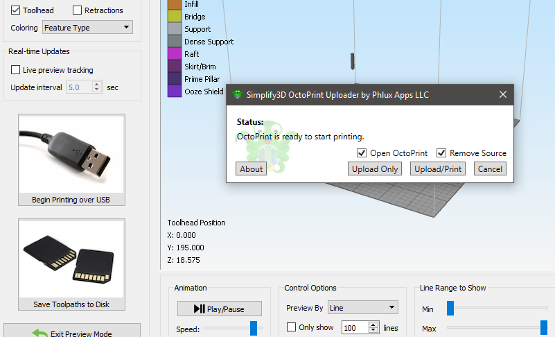

So I wanted a simple solution for windows users can use that did not require having an app running all the time in the background. So I built one.
Features
  • Show status of printer.
  • Only Upload.
  • Upload and start print.
  • Remove gcode file after upload.
  • Open OctoPrint after upload.
If you want to try it out you can download it here https://drive.google.com/file/d/1LJEcpi ... sp=sharing
If not installed already install the Microsoft .NET Framework 4.7.1 from https://www.microsoft.com/en-us/downloa ... ?id=56115
Setup
1. Extract files to local folder.
2. Open Simplify3d
3. Edit Proccess Settings
4. Scripts Tab
5. Under Additional terminal commands for post processing add be below line with your settings.
[Folder you extracted to]\Simplify3DOctoPrintUploader -f=[output_filepath] -s=[http://{octoprint ip address}] -a=[User API Key from ociprint]
The attachment is no longer available
