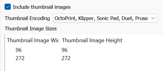

I just picked up a couple of Qidi Plus 4 machines and am slicing with 5.1.2.
I have not been able to get thumbnails to work.
If I look at a GCODE file with working thumbnails I see this:

Output from an S3D file looks like this:
Code: Select all
; thumbnail begin 96x96 5540
; iVBORw0KGgoAAAANSUhEUgAAAGAAAABgCAIAAABt+uBvAAAACXBIWXMAAA7EAAAOxAGVKw4bAAAP7U
; lEQVR4nO2cWXMbV3qGn9PYQRIAVxEESDYpS/Z4kT3U4qUikh57Eluyr1KVuchNUvMPkluNp6zy/Ipk
; 8g9S5YptJVF5EeUarxJtybY8lrU0FwDcsQkAAXT3yQW6CXCR4aZIyXbwFoo6QDdOn/PyPe/39XeaEv
; vSsfqn2krl1U+zYf3lK0v9vzCyaYJDN0Hx6v9J80JeXouD4wzj5DJPefoO1IfmPRlLp2cbh387HNfC
; XW6H1kHEikrcZ9xoMh6GeE1v+80AT/v4r2u0CLoCb4Jdek9wS/5JLrnqBl0k3Q8qAmaHlQE7QU1AQt
; D2qCloKaoOVBTdBSUBO0PKgJWpl0E7Q8qAlaHtQELQ9qgpaCmuD/ADiuNAkXs4djAAAAAElFTkSuQm
; CC
; thumbnail end
; thumbnail begin 272x272 22132
; iVBORw0KGgoAAAANSUhEUgAAARAAAAEQCAIAAAD3aLxCAAAACXBIWXMAAA7EAAAOxAGVKw4bAAAgAE
; lEQVR4nO29aXcb2Z3m+QsAgZ0AwR1cIeWidK5OpavHUzUpKZ1295mlP8N0z3yMktPHSvsjTJ3TM/Ni
; 3veZ9zNZ5bIk97jaZUu5OndJIEUS3EkAxA5EzIt7byACCwkoJRGU7nN0oNgQCID3ief//9/n3jD+7/
; Gdw2hoDAGtMBoaQ0ATRkNjCGjCAmLnxgAAAG9JREFUaGgMgYChkxgNjYGhFUZDYwjoqWI1NIaAVhgN
; jSGg+2E0NIaAVhgNjSGgCaOhMQQ0YTQ0hoDOYTQ0hoBWGA2NIaAJo6ExBDRhNDSGgPaSaWgMAa0wGh
; pDQBNGQ2MI6LKyhsYQ0AqjoTEE/n8PLw2VUyy8EgAAAABJRU5ErkJggg==
; thumbnail end
; G-Code generated by Simplify3D(R) Version 5.1.2
Nothing jumps out at me as a clear issue. I tried copy/paste to move the 272x272 preview to the top, but that doesn't change anything. Suggestions on what I might try here?
