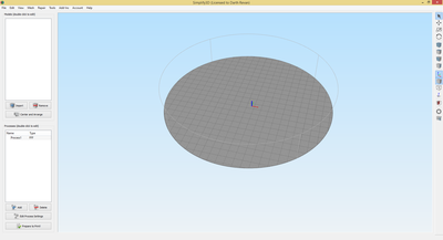

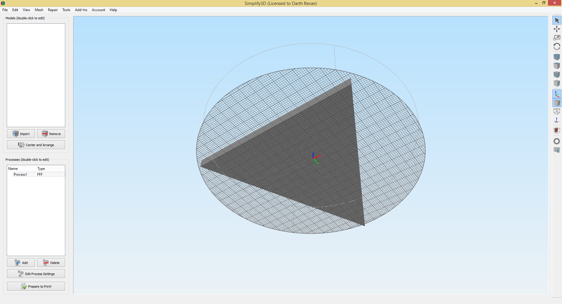

Pics:
Above with grid
Above with grid
Under with grid
Under with grid
Grid Disabled
Grid Disabled
