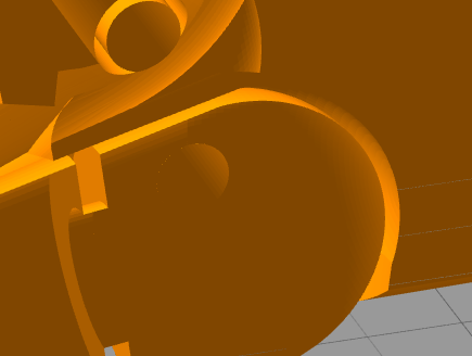

Hello,
I am having some difficulties slicing correctly the LFS_Elephant http://www.thingiverse.com/thing:257911
My problem are the top of the legs.
I don't know how to make S3D to give same vertical space between the top leg part and the body. Everything I tried does not seem to make any difference (top, bottom layers, horizontal spacing compensation, no infill, etc).
This is a cross section of that area
cross section
cross section
After slicing, that space seems to disappear/ignored, and the highest part of the leg gets cut off and the infill of the body starts overlaying it.
Here I have 0 bottom and 0 top solid layers, because if it does, then the solid bottom layers will be added just like in this picture the infill is, overlapping the cut off section of the leg.
sliced with S3d
sliced with S3d
The same area with Cura, only using the default settings. Leg gets filled completely and body does not touch it on that vertical spacing.
sliced with Cura
sliced with Cura
Screen Shot 2015-03-27 at 08.22.11.png (18.7 KiB) Viewed 7201 times
This is something that I would like to learn how to achieve with S3D.
Any tips?
Thanks

I have found the problem.
There is one setting in the Advanced tab that makes all faces merged together, and I had it checked.
Merge outlines
Merge outlines
Screen Shot 2015-03-28 at 18.40.43.png (19.68 KiB) Viewed 7200 times
Now the sliced object is perfect.
Vertical spacing preserved
