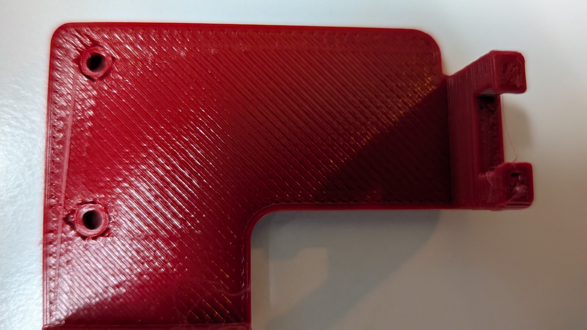

I am getting separation issue on bottom and top layers around small holes as seen in the photos.
Using Simplify3d 5.1.2. The part for scale is roughly 40mm x 30mm x 15 mm Hole 3mm diameter.
This is better that the last one which was 15% on the Outline Overlap. Current is 20%. Looking for any other recommendation to try to get the top and bottom layers better.

For the top layer, these changes should help:
- Increase Outline Overlap
- Decrease Top Layer Speed
- Increase Top Layer Extrusion Modifier
For the bottom layer, it looks like it's caused by the nozzle being slightly far from the bed. You can either change this in Simplify3D with Z-axis Global Offset or change this on the machine. If your nozzle is too close to the bed, you should see the printed line being too squished. Increase the z-offset to a positive value. If your nozzle is too far to the bed, you should see the printed line being a bit 'round' and not squished at all. Decrease the z-offset to a negative value.

Thanks I will try changing the parameter you mentioned.
