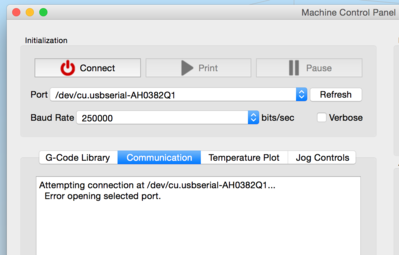

Posted: Sat Apr 16, 2016 2:04 pm
by amirox
i cannot not connect
OSx 10.10.4
S3D 3.0.2
i can connect with the "pronterface" but there i can choose another serial port the "tty" in s3d i can only choose the "cu" ... when i choose "cu" under pronterface this will also not connect, so it seems more an issue of the s3d software
