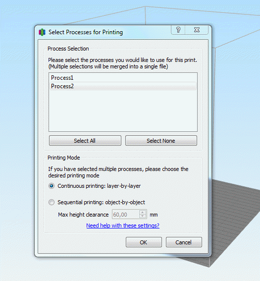

TheBum wrote: ↑Thu May 16, 2019 5:29 pm
The Select Models panel
does work to assign different objects to different processes.
... yes, but you have the occasion to exclude a process from printing in the following window, when you have select the "Prepare to Print"-Button. And this is exactly what you want.
GER
Re: Ignoring hidden parts when arranging, etc.
Posted: Thu May 16, 2019 6:46 pm
by TheBum
horst.w wrote: ↑Thu May 16, 2019 5:53 pm
GER
Not really. I don't want to necessarily create one process per object. The times when I've done that were either to work around the phantom supports
bug (supports sometimes generated even when removed in the custom supports tool) or to otherwise use different settings (e.g. different infill density).
