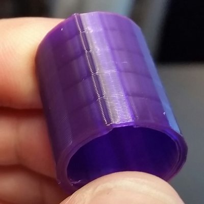

I've been using S3D for a number of years now, pretty familiar with it, but I'd never used the 'Coasting Distance' option : Have a bigger nozzle, getting some blobbing a the end of the extrusion that wipe isn't addressing, so I figured I'd try this.
And try I have: Probably 5 different test-cylinders broken into 5 processes each with difference coast settings. And none of them look any different. Tested this in both S3D 3.0 & 4.0. Save factory file, closed/reopend the software, turned the checkbox on\off \ resave etc. It just does, nothing.
Here's a pic of my end results. The nozzle is traveling screen left -> right, so the left side of the zipper coasting should address. I also turn off my fan briefly between sections so they're easier to tell apart. In this case, all the same:

Contacted S3D Support: With really big vals, like 5mm and greater, I'm starting to see some effect. Guess I didn't aim big enough to start.
