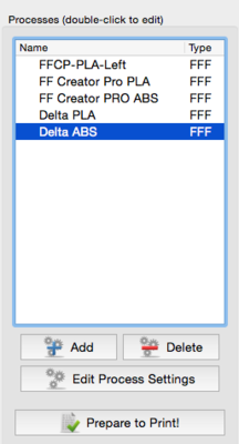

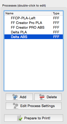

One common mistake with the process system is stacking up unneeded processes in the list:
Reasons why keeping a running list of processes is not recommended:
- For prints that take multiple processes such as Sequential Printing (1 process per part), you'll quickly run out of room when stacking these new processes on-top of your processes that you are storing in this section.
- If you select slice and then just pick the process you want to slice your model, it will not change your current Build Dimensions, Firmware Configuration or Bed Model when slicing. You need to open the FFF Settings window, and then click Okay to enable these overrides. If you have more than one printer, this means that using this workflow will lead to errors.
- When using features such as the Dual Extrusion Wizard, it will not give you the choice to select Processes you've created, it looks for Profiles, which is why it's important to save your settings as a Profile.
- Using the Configuration Assistant will delete all processes and only leave the newly selected file, which can be frustrating.
- Dual extrusion wizard will delete all processes and only leave the newly created processes, which can be frustrating.

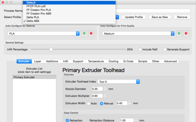

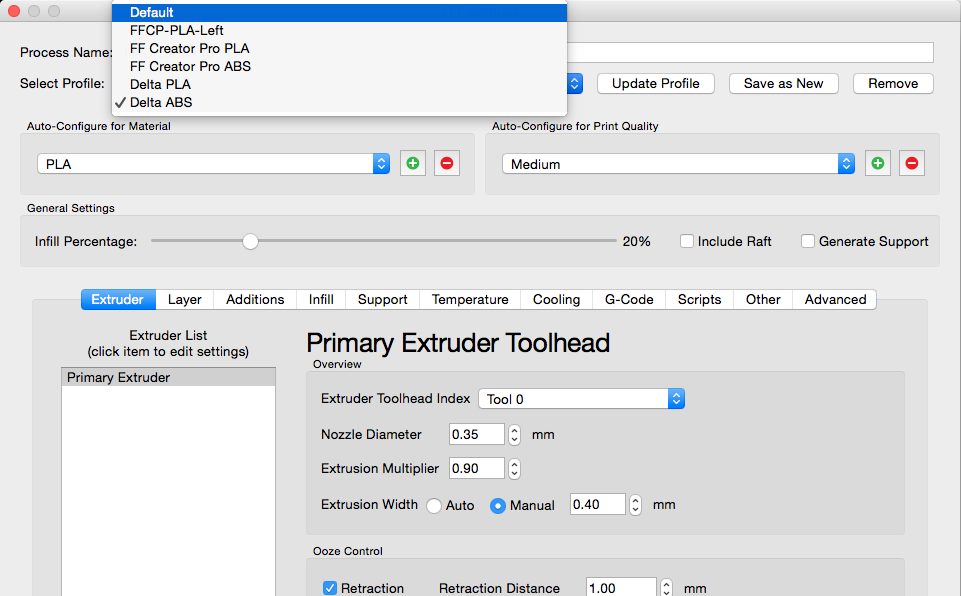

Recommended workflow
- The first step would be to go to Help-->Configuration Assistant and select the printer profiles you need.
- Then it's recommended to use the Save as New and Update Profile buttons to create a running list of printers and settings
- After you have these setup, you would just need to select Edit Process Settings and then select the Profile you'd like to use.
- Using this method will make the software much more intuitive and user friendly overall, so I highly recommend this workflow! :D

Profiles are extremely flexible to manage many printing situations. Another thing to note is the "Auto-configure for Material" and "Auto-configure for Print Quality" can be used to store presets for common print situations... all within the Profile.
This is probably just scratching the surface of stored parameters:
- "Profile": Nozzle, Print Speeds and a foundation for all other parameters.
- "Auto-configure for Print Quality": Layer Height, Perimeters, Top and Bottom layers, Infill %, Skirt/Brim
- "Auto-configure for Material": Temperature (Heated Bed / Extruder), Cooling, Extruder Multiplier
I find storing these help bridge the S3D gap between layers and measured height... translating the "Cross-section" Tools measured height to layers.
TL;DR - Experiment with parameters and familiarize between the different Quality and Material stores for more flexibilty
My general workflow - knowing that ABS is optimal for my printer entails dropping the heat bed to 100C and starting the fan when the project reaches 4mm in height:
- Select a "Profile" based on the filament material, print speed along with nozzle size (ie ABS_N5_Fast, ABS_N4_Medium, PLA_N4_Slow, PLA_N3_Slow)
- Select a "Quality" which is really the layer height (ie. Fine_Brim, Medium_Skirt, Coarse) which results in a stored thickness for getting the rigt perimeters and top/bottom layers (ie Thick = 2mm perimeters and top/bottom; Thin =1mm perimeters and top/bottom)
- Select a "Material" based on the filament and Quality (ie. ABS_Fine, ABS_Medium, ABS_Coarse) so that the heatbed and cooling start at the proper layer corresponding to 4mm.
The filing and different parameters are built over time... the import thing is to NOT overwriting your base profiles. :)
Sorry for getting into the weeds... hope it helps someone.
