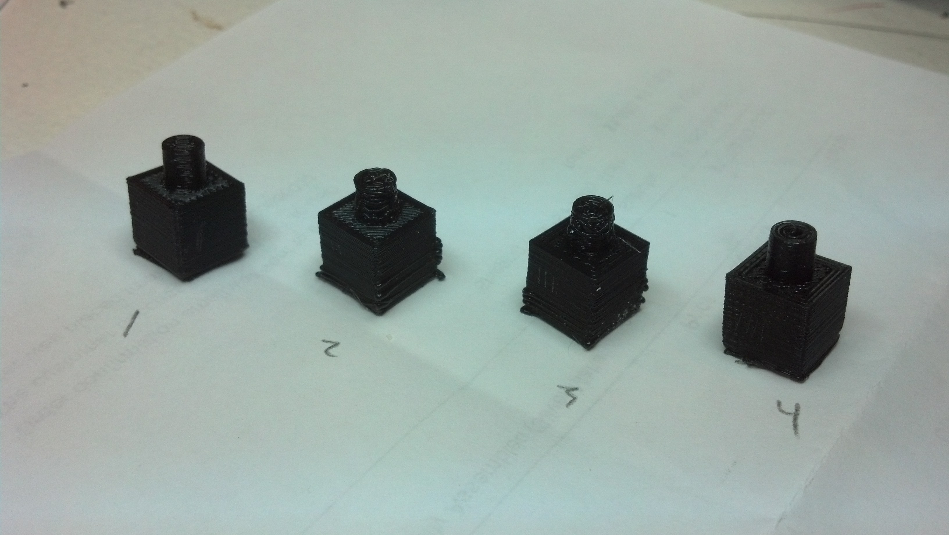

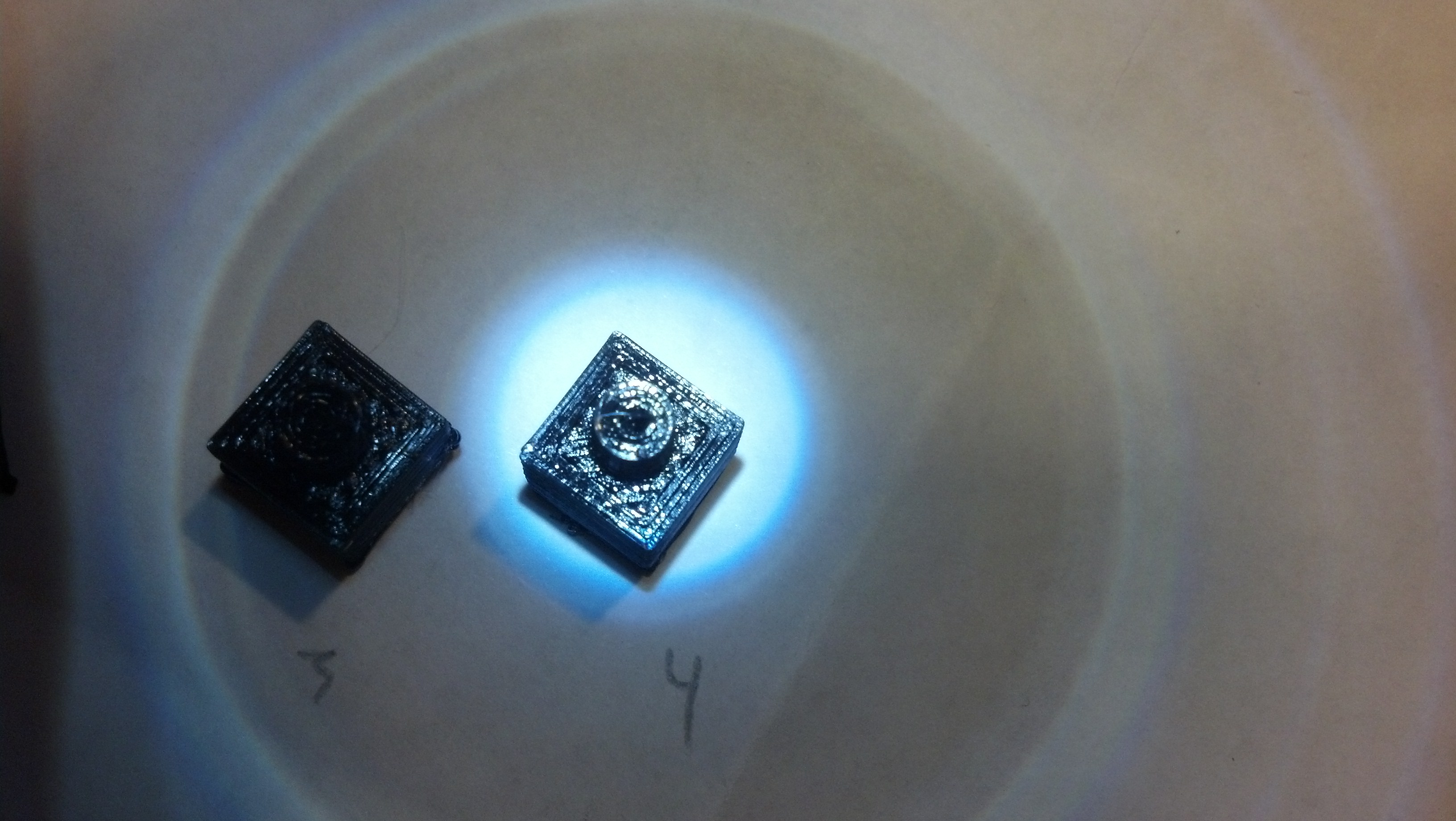

Here are some pictures of the test cubes I ran.
1 – Med quality G2/G3 disabled
2 – Med quality G2/G3 enabled
3 – High quality G2/G3 enabled
4 – High quality G2/G3 disabled

G2/G3 arc commands need to be disabled if you are using Marlin firmware

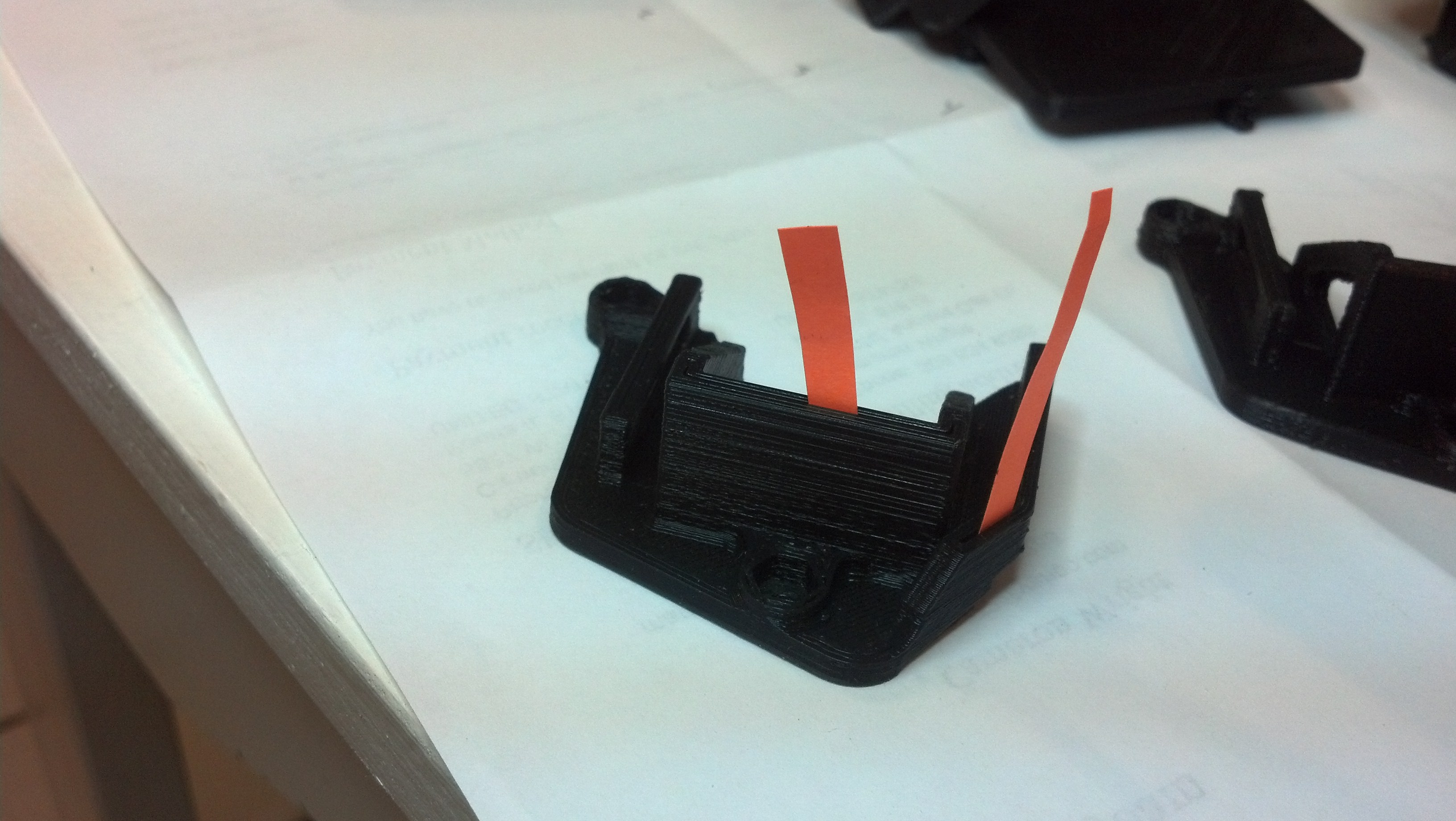

I just printed a part with 100% infill that left some uncapped areas. There is actually a cavity inside the part that is completely hollow. I stuck some strips of paper down them to illustrate.
I will be designing a lot of thin walled parts. The software and machine is completely useless to me if I cant do this sort of thing. The walls in the picture are nominally 3 and 4 mm respectively.
I've been playing with the minimum infill length parameter in the software. I turned it all the way down to zero, and it still shows these walls being hollow in the preview.
