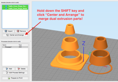

It took me a while to learn the SHIFT KEY trick with dual extrusion prints.
When you import the parts, they will be separated. But if you hold down the SHIFT KEY and click "Center and Arrange", those parts line up perfectly! Is that what you were describing?

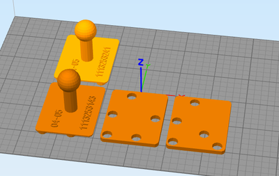

thanks for the info. Its close but not exact. The thing is, with your solution ALL the objects go to the centre. Thats not what I like, because i have multiple objects that belong together. See picture below.

Just select the model you want to align together and then go to Edit --> Align Selected Model Origins

thanks, thats the trick!
