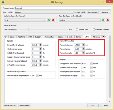

Thank you very much! That's exactly what I was looking for ...DarthRevan wrote:Hi Florian,
You can alter the filament properties the software will use to calculate things from the "Other" Tab. I'll attach a picture to help. The print time estimates are just that, ESTIMATES. The software can only calculate based on movement speeds, accounting some time for retractions and extrusion moves. There are some unknowns for each printer, such as acceleration values and firmware tool change dances. Since you have figured it out to be about half of your actual print times, you should just multiply whatever time it says by 2!

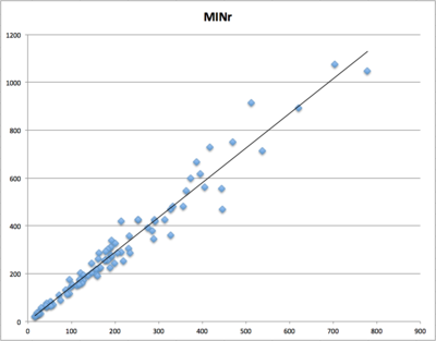

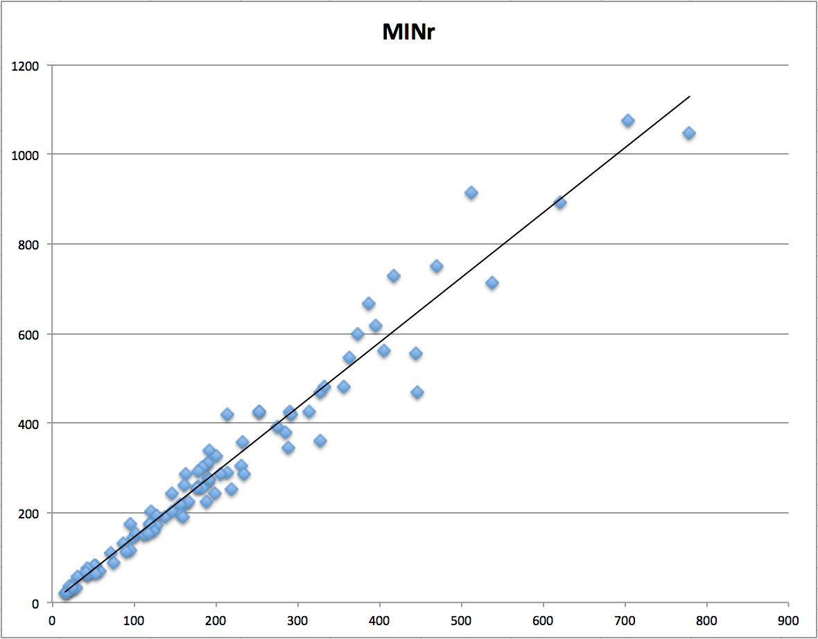

That would be great ...CT4 wrote:Might be good if in a future update there could be a field say under the filament properties which would allow the user to put in a fudge factor for the time on their own printer.
Unfortunately the fudge factor is not constant so would not be of much value. I have had 12 hour print estimates that were nearly dead on and 12 hour print estimates that were off by hours. Totally depends on how complex the print is, more complex the more acceleration slows it down.fthieringer wrote:That would be great ...CT4 wrote:Might be good if in a future update there could be a field say under the filament properties which would allow the user to put in a fudge factor for the time on their own printer.
