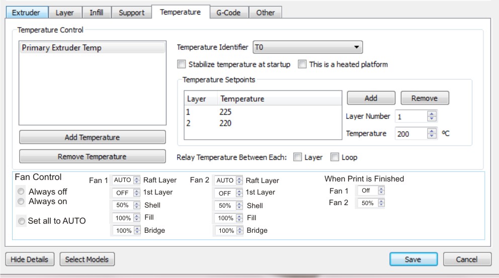

After reading these forums for the last 6 months I can say there are people trying things that I would have never thought of doing. And trying to anticipate the creative ways people will use this software is almost impossile. The attached image is my best shot at giving everyone enough to avoid redoing this several times. I hope my intent is clear.
Fans option
Fans option

These are great suggestions guys! slipshine, thanks for the image! That definitely covers a lot of the usage scenarios that I can come up with. We're going to start coding some of this up this week, so if you have any other ideas, now's the time!

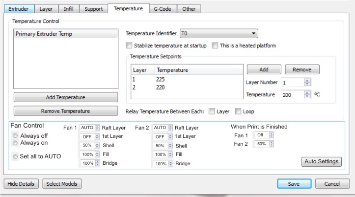

The only additional thing I could think of in addition to what I have suggested is
since the settings for auto have to be put in anyway you could add a button to
give access to them then have them editable in that section would be where
you could build a level specific interface. That way only the real power users
would ever need to go there.
You could even later then add Auto1 Auto2 Auto3.
Or Auto-ABS Auto-PLA ect.
If you want a sketch of what Im talking about I would be happy to provide one.

I think I followed about half of that... A sketch would definitely be helpful if you have time. We're hoping to finalize these settings this week so input is appreciated.

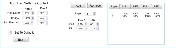

slipshine
Posts: 86
Re: Ideal Fan Control Settings
main screen
main screen
As Discussed earlier the above panel should meet just about everything someone would want.
Please keep in mind what I am sugesting is a bit over the top but its worth mentioning.
With the above configuration the novice would just set everything to Auto and run. The more advanced user
would have tons of settings to use .But since you have to setup the parameters for the auto in your software
I proposed adding a button (Bottom Right) allowing someone to alter these advanced parameters.
