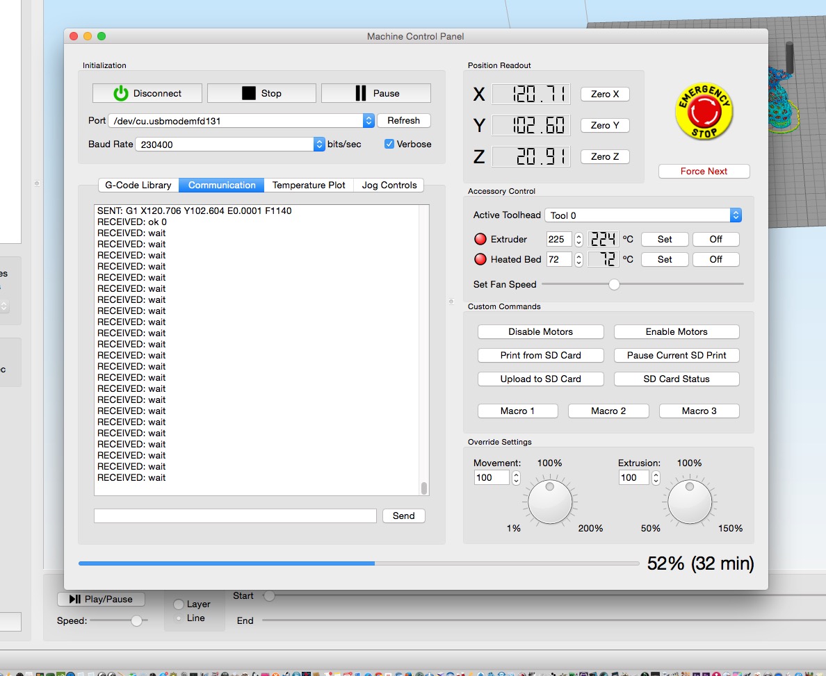

jeanluc
Joined: Wed Nov 11, 2015 5:16 am
Re: USB Print Jobs hangs after upgrade to OS 10.11.1
Wed Nov 11, 2015 6:34 am
this is the monitor window, it looks like a buffer problem to me :
Wed Nov 11, 2015 6:57 am
If you're getting those annoying "wait" commands, there's an easy fix that I did. Just edit the Configuration.h file for your firmware (which I'm guessing is Repetier) and comment out the following 2 lines:
//#define ACK_WITH_LINENUMBER
//#define WAITING_IDENTIFIER "wait"
They also recommend doing that here: https://github.com/repetier/Repetier-Fi ... stallation
