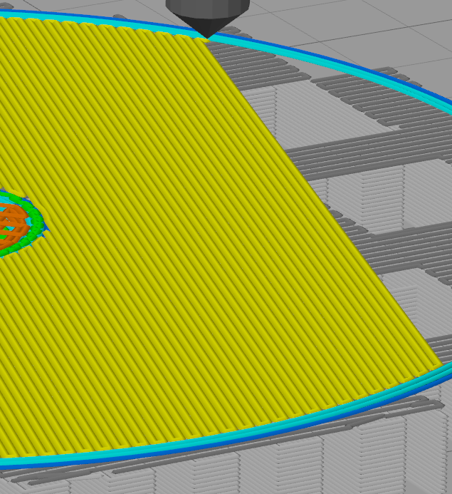

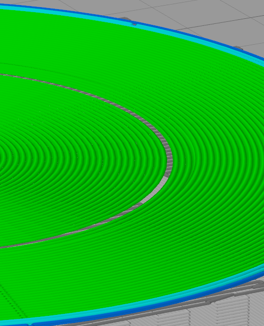

I am trying to use concentric solid infill, and found that there is unnecessary gaps. See the following picture.
I am printing a vertical slop here. The gap is filled in the next layer.
I've set the infill overlap to 50% but no help here. I think it is because the software insists on infill with a loop here, but a single line infill would be perfectly fine. Am I missing something?

I just encountered this too in the latest version (3.1.1), so it's still not fixed. The problem does indeed occur where a single line needs to be laid instead of a loop.

This is still an issue in 4.0:
Concentric:
Concentric Infill
Concentric Infill
