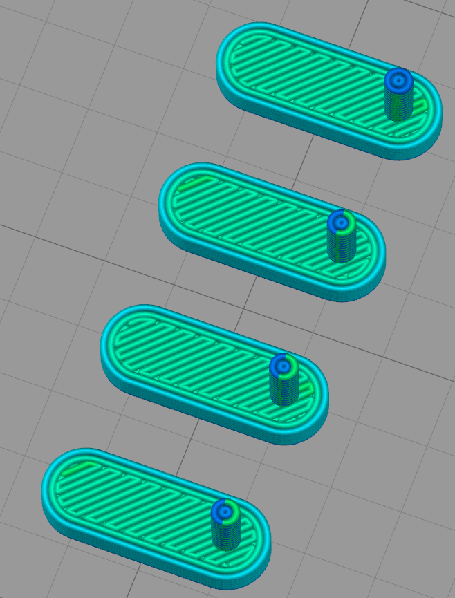

Movement speed is too fast during wipe
I experience problems with printing small parts with wipe feature enabled. The printing speed adjusts according to Speed Overrides settings in Cooling tab but final move when wipe feature is taking place is going too fast with default printing speed. If layer printing time is big enough then wipe feature is going with the default printing speed which is differs at 20% from infill printing speed and there's no visible problems.
I ask to correct movement speed during wipe according to previous feature printing speed.
