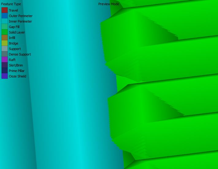

I can't seam to get the infill to overlap the Outline/Perimeter Shells.
See screenshot.
Is there a way to do this?
Attached are the settings.
What would the setting be to overlap them?
Thanks

Make sure you look close and from different angles. I show some overlap on my latest job.
Re: Infill to Outline
There is a setting on the Infill tab that is called "outline overlap". Increase that value if you want more overlap
