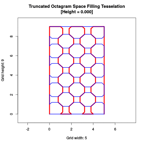

Do you have any data to share on this? So from my experience the traditional alternative fill shapes that are currently available only add strength in one direction. Just to check we're on the same page, technically I'm asking about tessellated truncated octahedrons, not really hexagons. This is what the layer by layer print looks like... Every line segment is firmly attached to the others, there are no gaps.
tesselation of a truncated octahedron
Lots of details on how it's built in Slic3r here - https://github.com/alexrj/Slic3r/issues/1646
