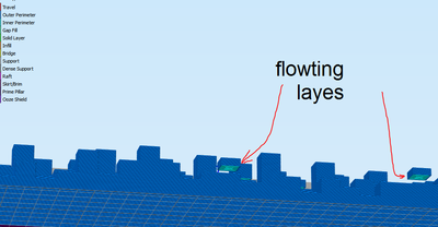

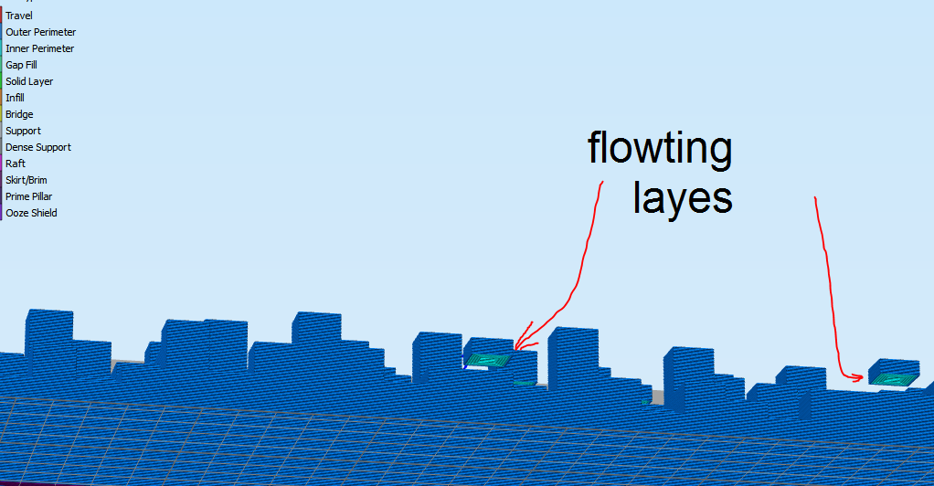

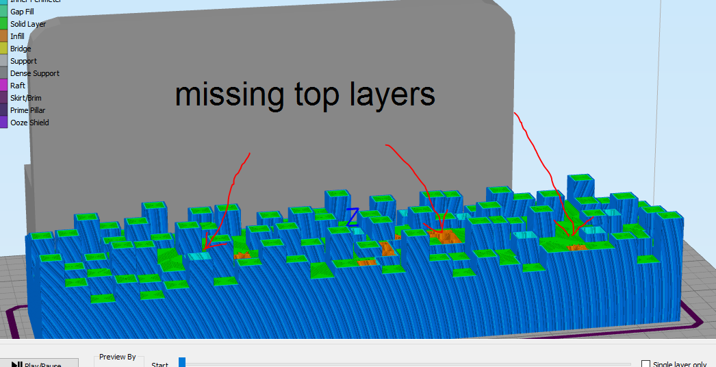

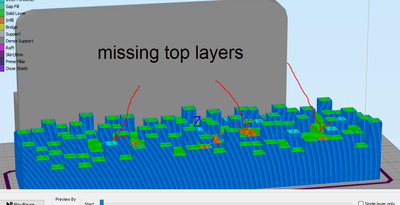

been trying to print somthing...
in SKP the model is all solid..(solid inspector)
in S3D main window/preview looks solid and printble (used cross section to chack)
after slicing layers "disappear"...making floting layers in some places and top layer missing in others...
most of the model is fine but those places...
what im missing?
cheers

Re: missing layers
My guess that what you're missing is a good model.
I'd run the model through the cloud repair service and try again.

Re: missing layers
Please upload your model!

Re: missing layers
dkightley wrote:My guess that what you're missing is a good model.
done!
thankes...
it fixed the floating layers...
but still missing some top layers i some places
MasterFX
Posts: 208
Re: missing layers
I looked at you file and it seems like your model is corrupted. You should try to redesign it
