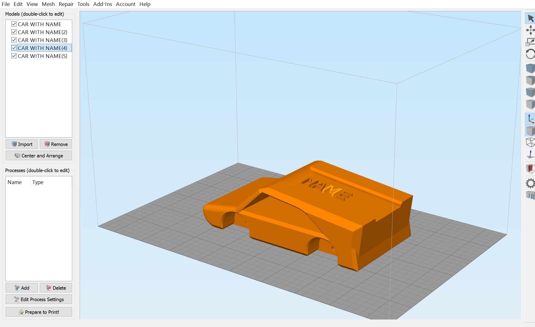

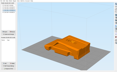

It doesn't work perfectly to do the "Separate Connected Surfaces" function, but it will work til I figure out how to export them from Inventor in the correct way. I attached a photo. It actually splits all parts of the separate bodies off, so each individual letter is its own model. No bid deal for this application, it will work. If one had a bigger file and had 2 bodies with multiple sections that had to printed with each extruder, you would have to be really careful when selecting which models are being printed by which extruder, as everything not connected would be broken off as its own model.
The ultimate solution would be able to export 2 solid bodies in Inventor as STLs and use the "Align Selected Model Origins" function. I do have a post over on the Inventor forums, but no solution that works yet. If I find one I will post it here.
Thanks Doug! I have only seen the "Separate Connected Surfaces" function used to break up STL files into separate bodies that weren't actually connected, never thought it would actually separate connected surfaces :)
