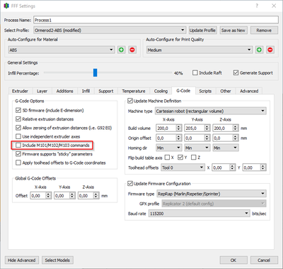

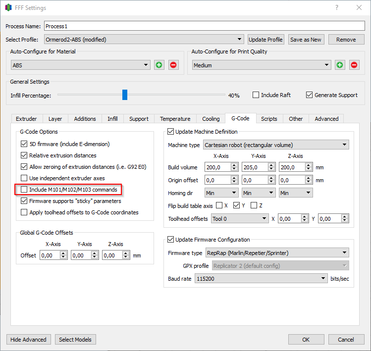

The option is unchecked at the settings page.
Settings
Settings
I reported this error already to the support.
I don't think I did something wrong as I used the Factory-file from version 3.02 and changed nothing special.

I wonder which setting is causing those M103 commands to be sent. I'm using a different printer (Duplicator i3), and I also have that check box unchecked, and I'm not seeing any M101-M103 in the generated G-code. That implies that there is some other setting that is causing/affecting the software to emit those commands.
