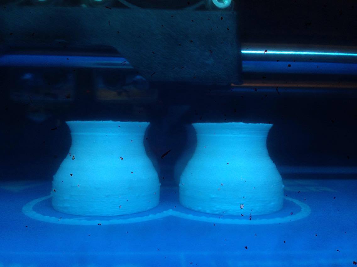

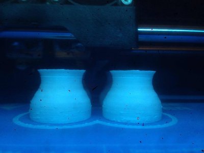

so far... im having bad quality in my ABS printing....
but the last one was awful :roll:
https://www.myminifactory.com/object/ar ... -lamp-6790
as you can see in the pictures...
- layest arnt homogeneous....and gots a lot of "lumps/zits"
- brim is grainy..
- last printed layer isnt flat...so the nuzzle grind it
- "doughy" like layers which cracked eazy
FFCP
layer hight-0.2
temp 230/110
speed 60/70
srry for the bad ENG

haha yes, it's hard to see from the camera.
I'll just respond to your text with common issues that ABS can have:
- brim is grainy..
I think that you may actually be printing too hot. The lumps/zits sound like it can't retract, and doughy like layers may be a result of too much heat build up.
If you try printing at 220/80 and see if that moves things in the right direction, that may be a good first test.

that made a big diffrence ..THANKS :)
still not as pla...
but ill try tweaking with the temp...
thanks again:)
