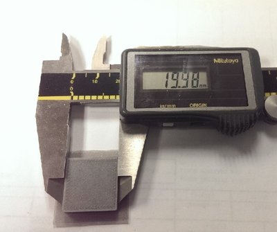

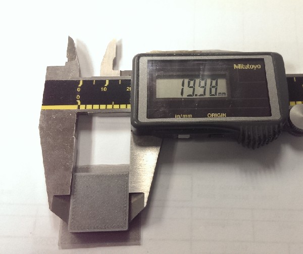

Festus440
Posts: 77
Joined: Wed Aug 07, 2013 8:38 pm
Re: Help me Calibrate
As jimc said:
<once you are getting nice clean prints then pull out the calipers
If your part is warped, the dimensions will not be correct. You will also get more shrinkage with 100% infill.
Work on getting clean, flat, straight walls and that the part remains firmly attached to the bed all around the outside edges.
Once you have that you may have to adjust the scale to get better accuracy but it should be closer than what you are getting.
You may want to go back to using PLA to start with. It has less shrinkage than ABS. (The part in the photo happens to be PLA.)
You mentioned printing on tape. There are lots of methods people use prepare their beds. I use blue painter's tape with the bed heater turned off. (For PLA.)

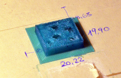

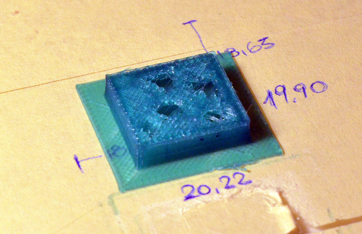

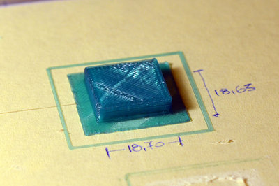

raffo333
Posts: 25
Joined: Mon Feb 10, 2014 5:12 am
ok, ive made some tests, and this is BAD, PLA as you told me, 1.0 Multi, but i also used the bed to 60c
I can see also some extruder problems .... and the dimensions are also OFF... :cry:
Ive made also a Makerware print for comparsion
SD3 Print
Makerware Print 10% infill ( much worst print but closer dimensions )
this is getting really frustrating ... :oops:
