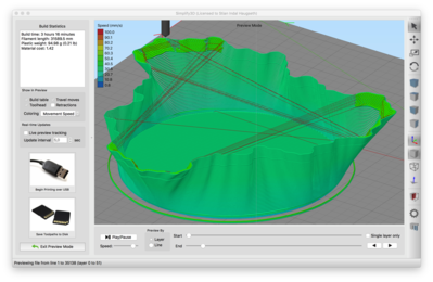

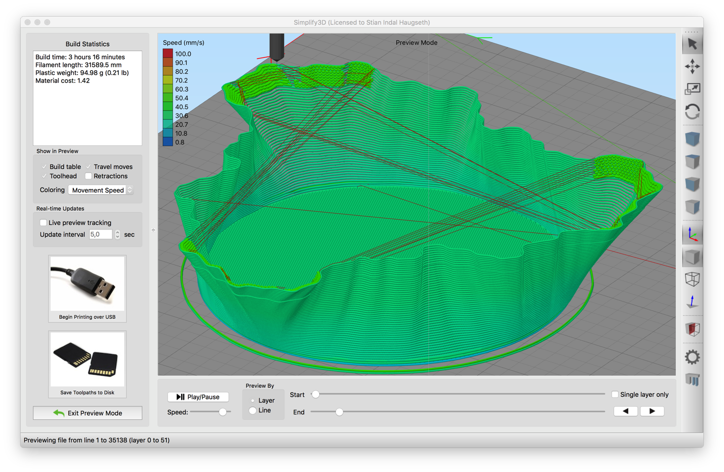

I want to print this vase but looking at it sliced it looks like to be partly vase and regular printing. Even there is no islands or very steep overhangs. I even ran it through Meshmixer to see if it could repair anything.

It always switches back to normal layer-by-layer printing if the layer can't be printed with case mode. For example, if you have multiple islands or other features that can't be printed in a single spiral. So I expect there is a feature in the STL file that is preventing it from printing in a continuous spiral.

Yeah, it looks to me like it's switching to non-vase mode because the overhangs there are way too steep. The filament on one layer's perimeter wouldn't be touching the layer below when printing, which isn't going to work...

Could it help to use a wider nozzle and wider wall width?
And/or slim the vase by scaling only XY?
Need to try this when I get home.
Re: Vase mode issue
dorsai has it right on. the problem here is that the perimeter is stepping over so far that there is a gap it needs to fill. you can A, lower the layer height, B, increase extrusion width. probably best to do a combination of both.
