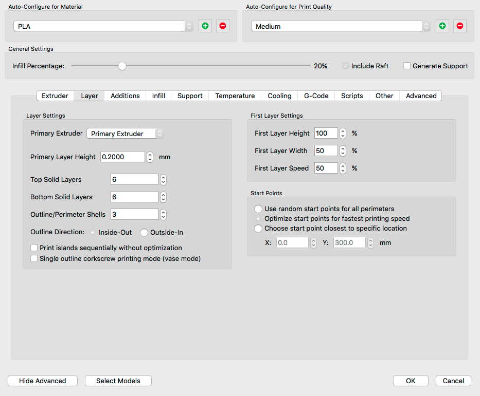

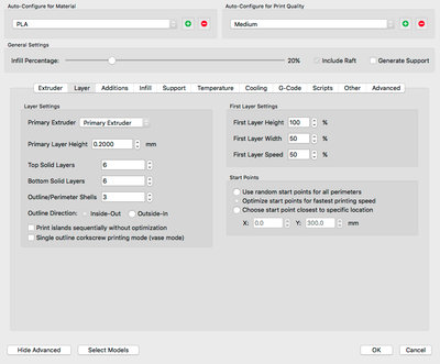

nxym
Joined: Sat Jun 03, 2017 7:38 pm
Re: First print layers density question
I have similar problem and i solve it.
Forget what mechanically does every aspect of this program.
Put a model like the one i attach and change every aspect one at a time to see the behaviour of first layer. Look at the gcode on "prepare to print" what is changed from the bottom camera.
From my experiments i found that if i want a first layer WITHOUT gaps i must LOWER the "First Layer Width" to 50% of my extrusion width (which i manually set it in the same size with my nozzle diameter in extruder tab).
That tells to print a layer bottom solid fill with lines that will have smaller width (0.2mm for my case) and such will print more smaller lines that fills the gaps.
Also in my case i have on Infill tab an outline Overlap 60% so i can make parts with holes on it without any gap.
You can put more percentage on thin wall behaviour for the gap fill on Advanced tab but i don't see any improvement.
So If you want to print Small lines (like High res on print glossary) at the vertical axis you put small number at the Primary Layer Height and that improve perimeter of your object and for the horizontal axis you play with extrusion width and all others that has a behaviour with that such first layer width and top/bottom layers. Keep in mind that nozzle diameter is a limitation for that width and with some tricks the software try to make a smaller width from a bigger nozzle hole so if u want truly small width u must change your nozzle to a smaller one!
I hope thats help.
