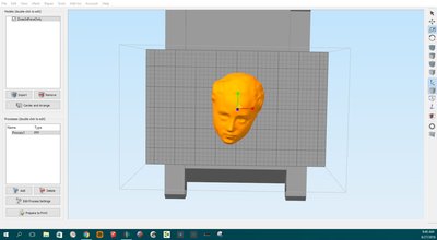

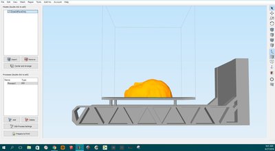

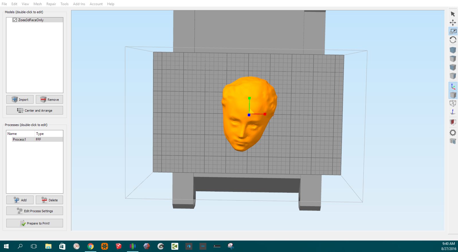

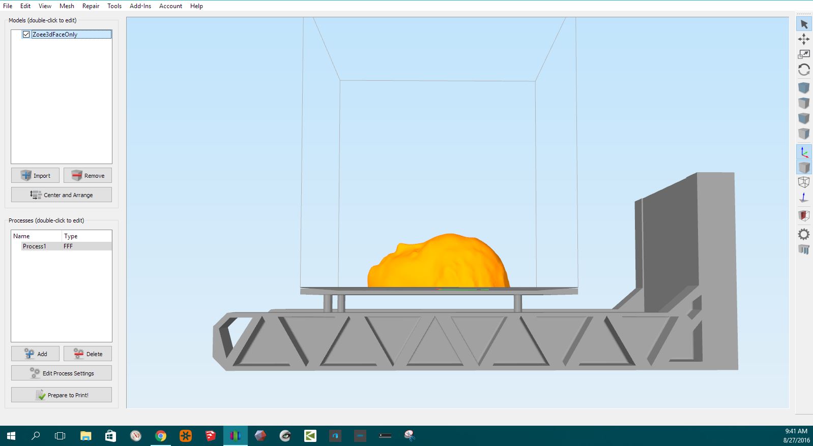

I am trying to print a 3d scanned face of my neice. I have successfully printed a version of my son but I only used a single process. What I have done thus far is split the original scan down to her chin and beginning of her hair line in order for the print to have a flat section to lay on and not use support. As this is my first real trial at multiprocess printing I just dont now how to proceed.
What I would like to do is print all facial features at .1mm layer height with the top 3 or 4 layers printing solid. Everything interior to this would be at a .2 or .3 layer height and 30% infill. Ill try and upload a picture to show what Im starting with. Essentially I guess this would be an outer shell at .1 and interior of .3.

I don't think you need multiple processes for that. Can't you just go to the Infill tab and tell it to print the infill every 3 layers? Then if you layer height is 0.1mm, your infill will only be printed once every 3 layers (i.e. 0.3mm thick)

You are correct sir, I was just going through the first process when I realized it could all be done in 1 process. I scaled the model down and this print should finish in approximately 1h17m.
