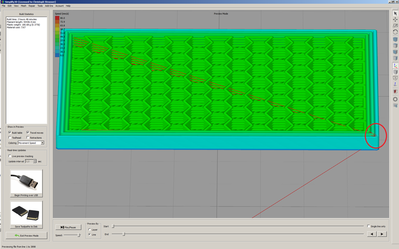

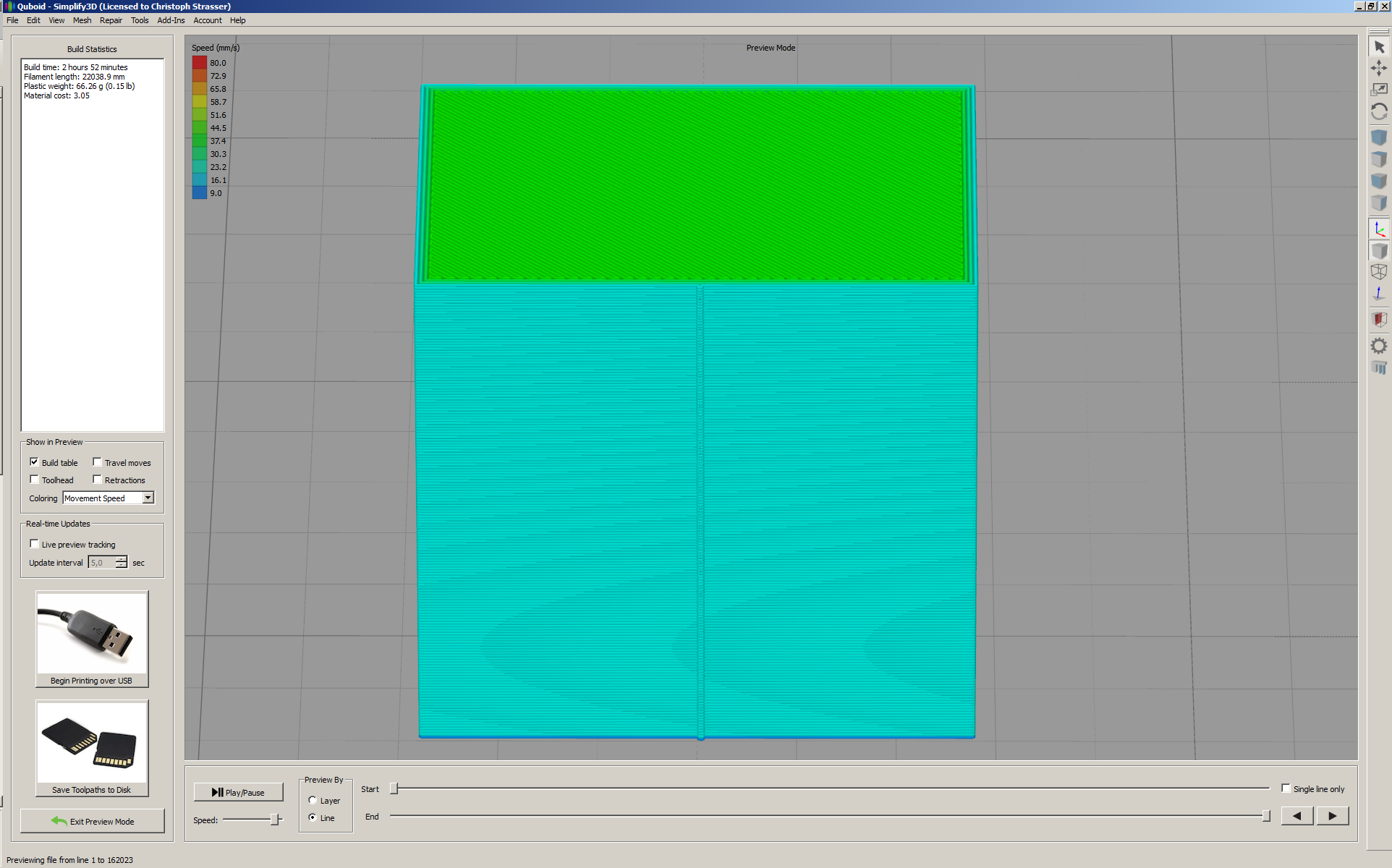

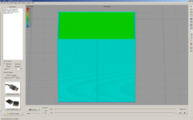

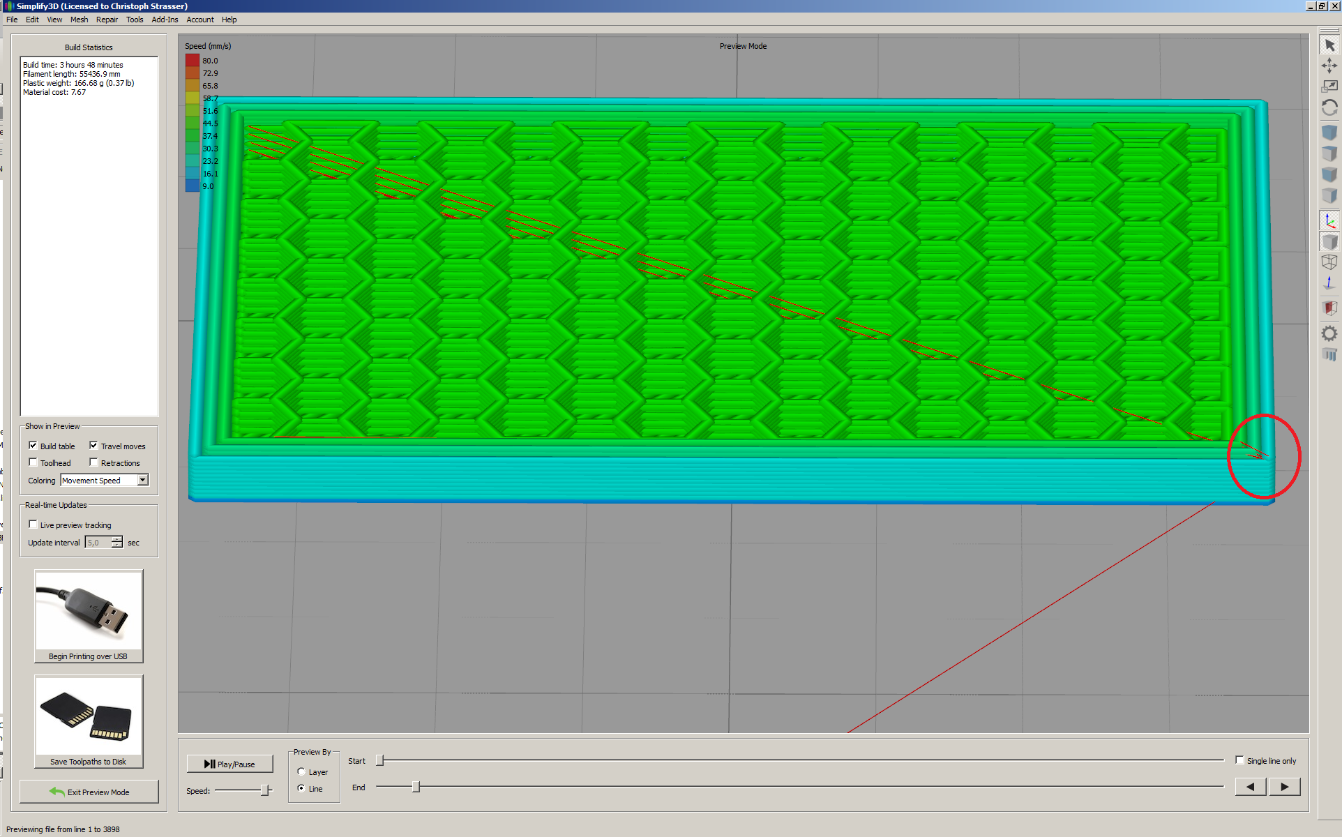

I just tried again with a simple cuboid having the following coordinates for start point (x = 200 is the mid of the cuboid) :
1st try: x = 200 (mid of cuboid), y = -9999 --> Start points in right corner, viewing from x-axis
2nd try: x = 200 (mid of cuboid), y = 0 --> Start points in right corner, viewing from x-axis
3rd try: x = 190 (left of mid of cuboid), y = -9999 --> Start points in left corner, viewing from x-axis
4th try: x = 190 (left of mid of cuboid), y = 0 --> Start points in right corner, viewing from x-axis
If I try y = 9999, it just flips the start point to the other side, but again just in the corners.
So no matter what I try, the start point always ends up in a corner.
Here are some pictures and the factory file:
x = 200, y = -9999
x = 200, y = -9999
x = 190, y = -9999
x = 190, y = -9999

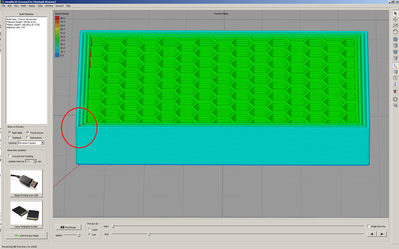

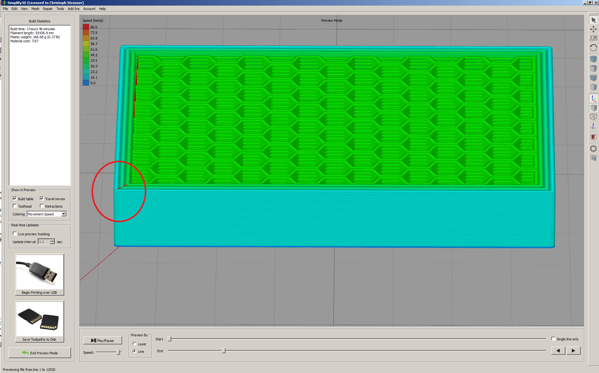

What I want is the start point to be in the middle of the Cuboid:
Here :)
Here :)
Re: Start points (again)
You can't put the start point there, because the printer never stops there. It prints that entire side as a straight line. Same with the 3 other sides. So if you are printing something like a simple cube, then the only possible places to start or end are in the corners.
