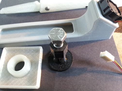

Regarding S3D, attached is my fff for eSun PLA pro (black). Be sure to address machine differrences, including my gcode scripts if they get included in the fff.

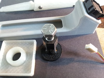

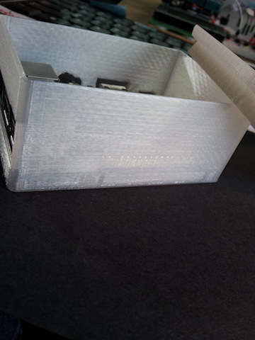

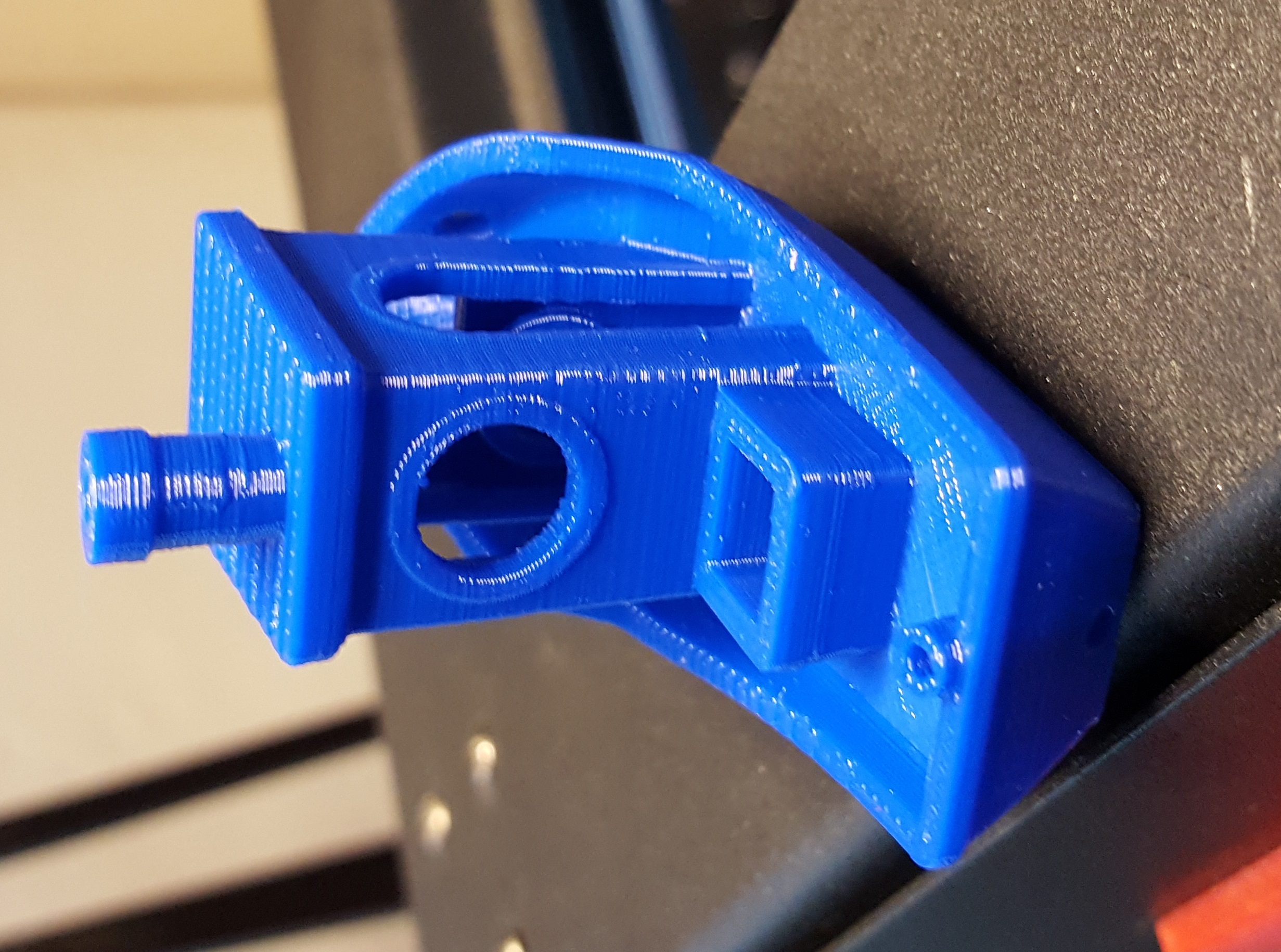

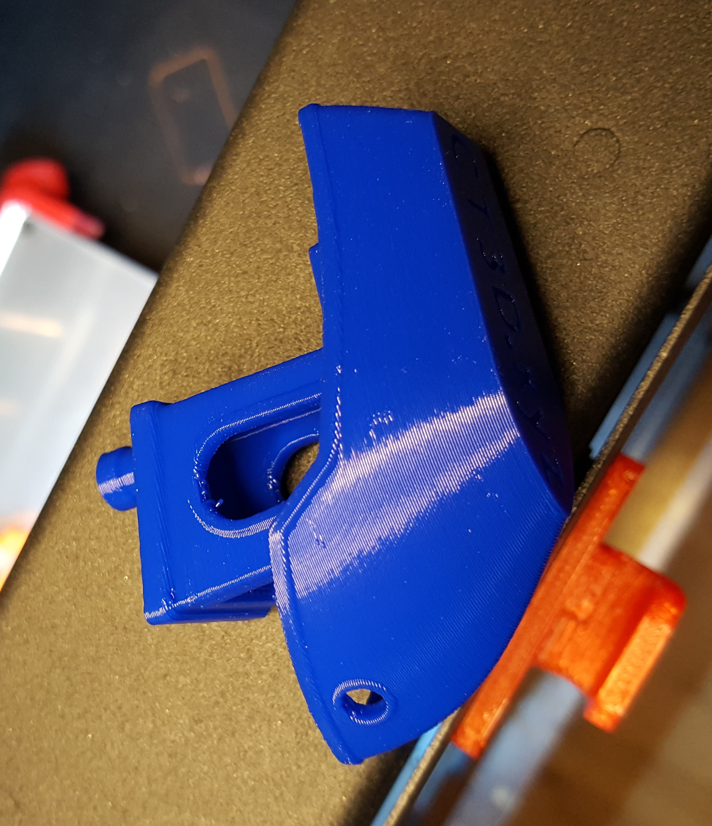

Also attached are images of some parts...
Prusa_Blk_eSun.fff
FFF
(14.14 KiB) Downloaded 588 times

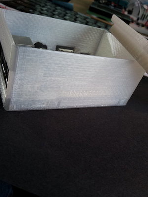

Thin wall (0.07 inch) box for Raspberry Pi
collection of part
collection of part
3D Print Parts

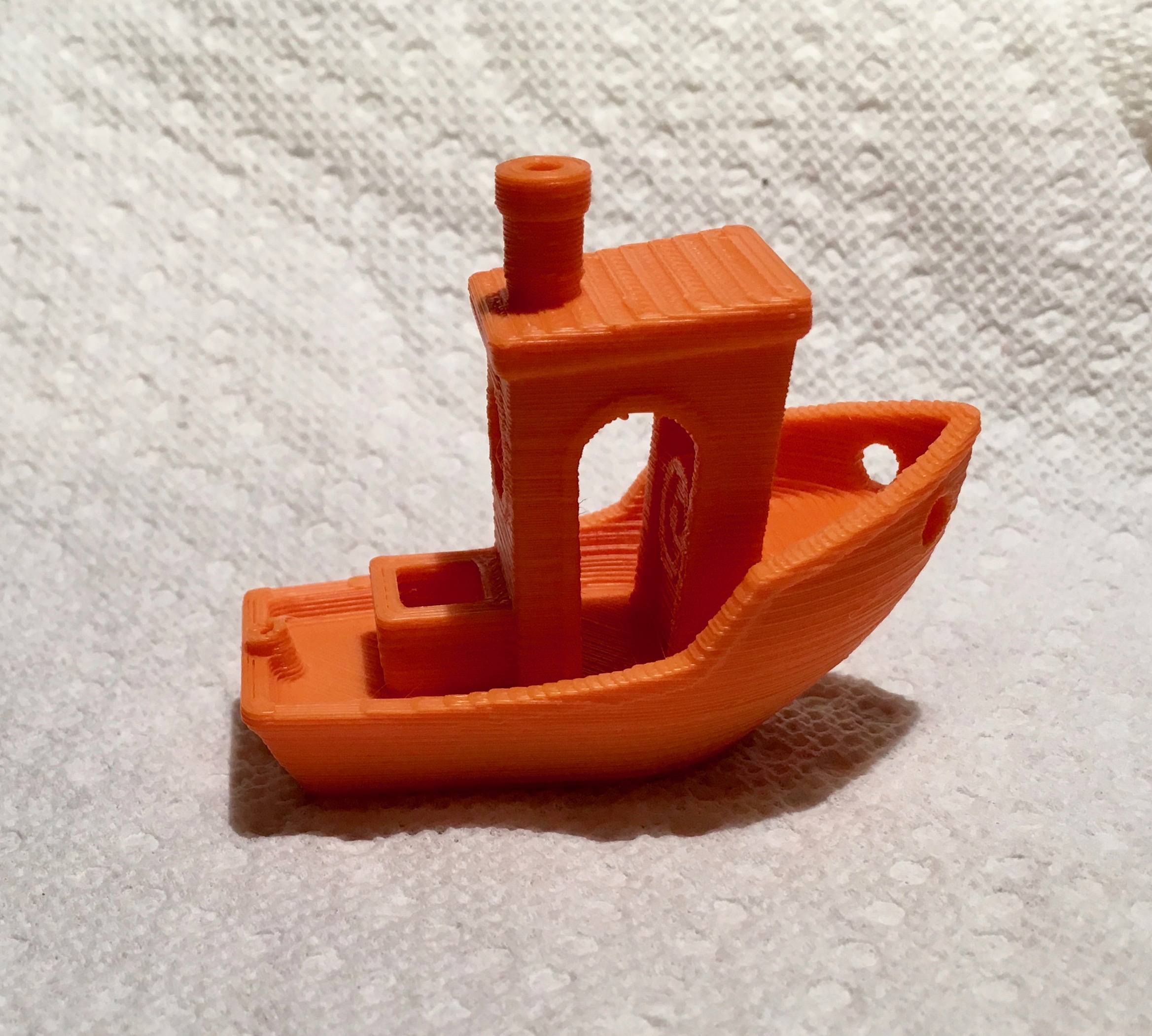

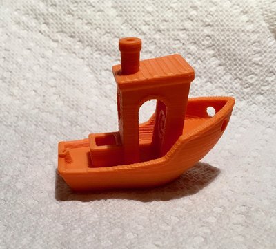

I've been printing 20x20x10mm cubes (or boxes) over the last couple of days, trying to improve surface quality. For an example of where I was starting the day before yesterday, here are a couple of 3DBenchy photos. My tests are better, but I still have some tweaking to do, so any advice is appreciated. I've attached the FFF I used to create the 3D Benchy print.

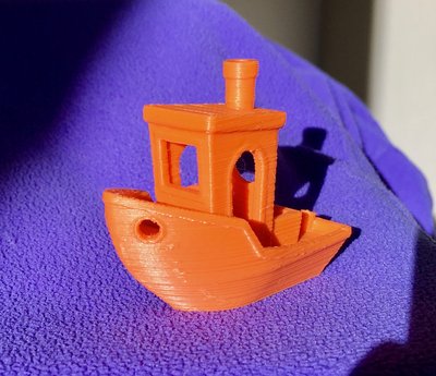

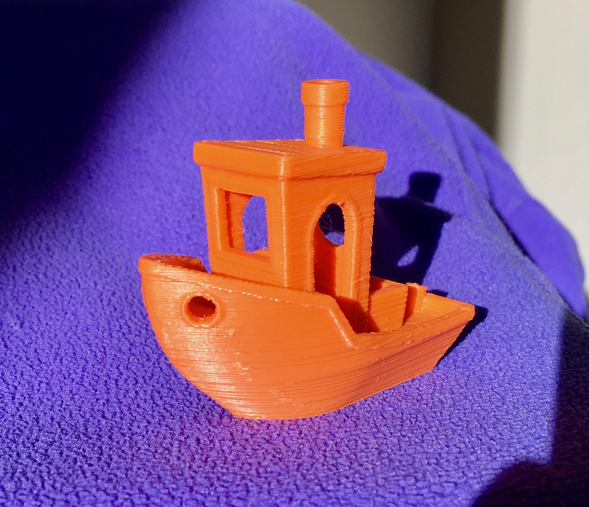

Here is Bnechy on My MK2 in PLA.
JohnOCFII
Posts: 34
Joined: Tue Jul 19, 2016 1:26 pm
Location: Minnesota, USA
Re: Any S3D users have an original Prusa i3 MK2?
wirlybird wrote:Here is Bnechy on My MK2 in PLA.
I think your 3D Benchy looks really good!

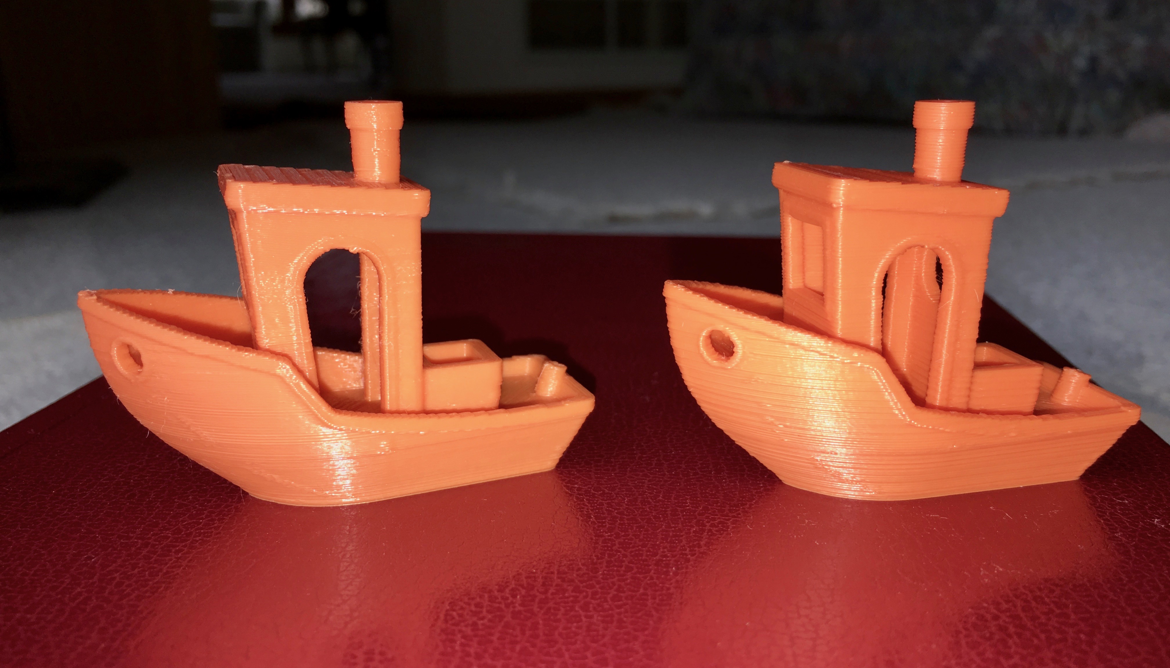

I stopped after 17 boxes. I reprinted my 3D Benchy. I'm satisfied for now. Thanks to GreyBeard for the pointer to acceleration values. I realized these are set in the starting script provided with the RC4 FFF from Prusa Research. I modified mine to match the settings Prusa uses in the Slic3r configuration:
Code: Select all
{REPLACE "; outer perimeter\n" "; outer perimeter\nM204 S600\n"}
{REPLACE "; inner perimeter\n" "; inner perimeter\nM204 S800\n"}
{REPLACE "; solid layer\n" "; solid layer\nM204 S1000\n"}
{REPLACE "; infill\n" "; infill\nM204 S2000\n"}

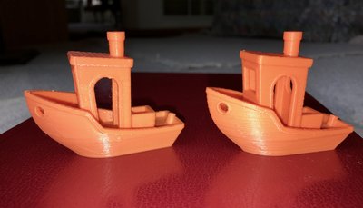

I've also attached my FFF. Here is my improved 3D Benchy. Surfaces are much smoother with the Raptor PLA.
3D Benchy, after: left side, before: right side
