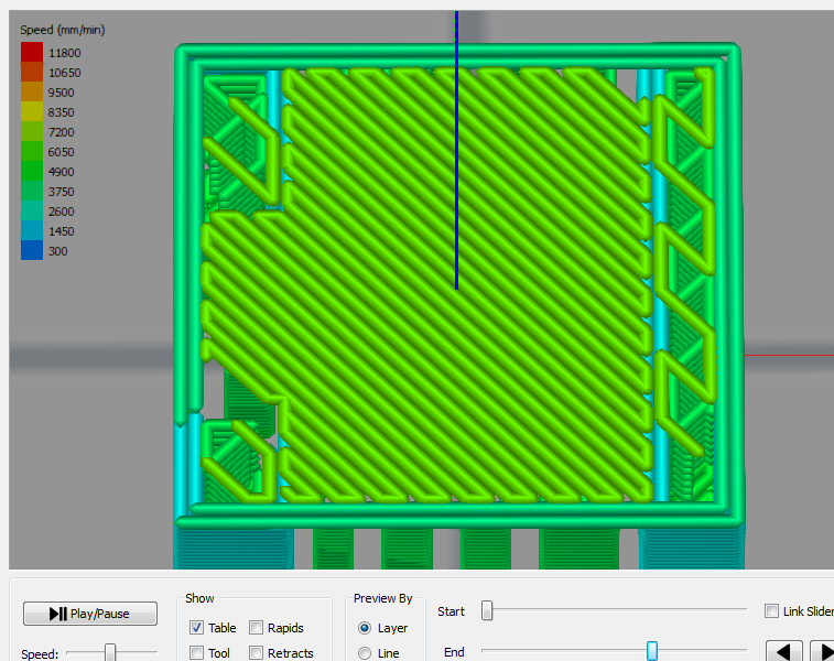

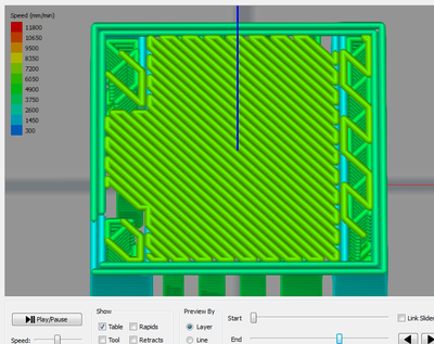

You can see the attached image, the right and some parts of the left side of the bridge fill seem to overlap one of the perimeters (this is a block with two legs on the left, and one long leg on the right. But, the top, bottom and far left of the bridge fill do not overlap the perimeter.
What is even more strange is when I print it, none of the fill overlaps any of the perimeters below. I verified with Makerware, same part, and the bridge overlaps all perimeters. Something is up with the slicer?

Have you tried lowering the "Unsupported area threshold" under the Bridging options?

Tried enabling and disabling bridging (1mm or 99999mm), this happens regardless.
