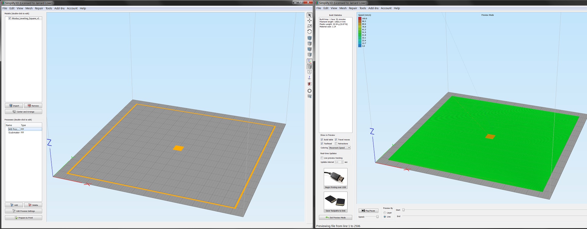

I have been wanting to print this bed leveling square for a while on my LARGE format printer (Modus) but Simplify3D keeps filling in the gaps which is infuriating me! Check out the images attached.
S3d is filling in this object layer!

This issue doesn't appear to happen with Cura, and I made sure I haven't got any support or additions turned on. Tried every option I could to resolve this and I'm starting to think this is a genuine fault with S3D!

It might help if you posted your factory file

Sure, I have it attached below.

The mesh for the shape has some issues with it.
I ran the mesh through one of the online repair services....and then reimported it into S3D. The outer perimeter printed fine.....but the small square in the centre is too thin to print. Lowering the layer thickness down to 0.2mm results in the shape slicing okay.
I would suggest you remake the part with a CAD package that can handle the shape.

I was using tinkercad and I did test it at 1mm height before and same issue. S3D refused to print this object no matter what I do. I'll just make it out of rectangles instead, rather annoying since Cura is A OK with it and S3D has a fit!
EDIT: Ok that solved it, seems tinkercad was causing errors in using a large primitive and cutting out the inside like I did, still strange how Cura was ok with it, anyway solved for now. Cheers.
