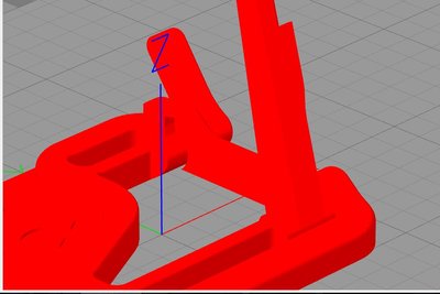

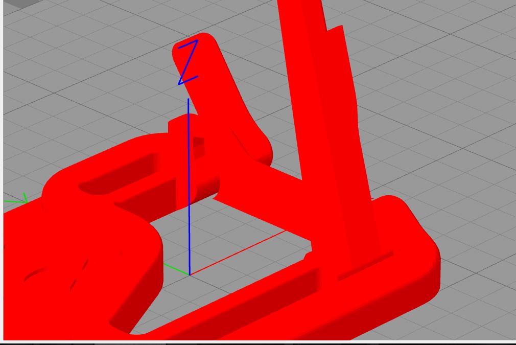

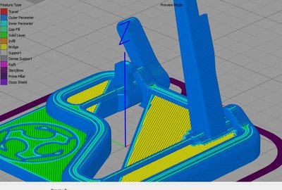

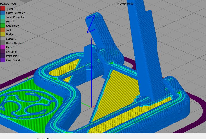

Please look a the pictures, and tell me why this is happening??
How it slices...
How it slices...
How it should look.
How it should look.

Attache your STL-File, there is an additional bridging, mostly caused by issues of the model.

Most likely a problem with your STL file. Run the S3D repair checks to see if it identifies problems. If it does, then you need to repair the STL file first.
Re: Slice is adding extra wall and bringes...
You could try a little trick to work around the issue. It may work....
Add 0.0001 to your layer thickness. If it doesn't work first time try adding the same amount again say up to a max of 5 times.
If it works...it works. If it doesn't, you'll need to get your stl repaired,

This worked!!!
