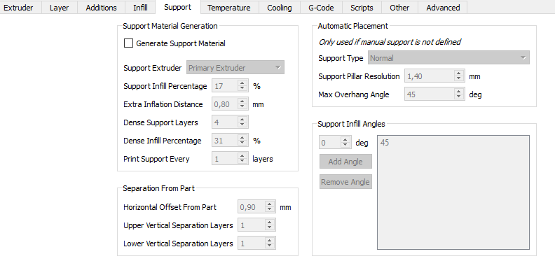

currently i tryed to print a few Things and the Support Material sticks realy hard on it.
I only can remove it if i use a Scraper or something else with many Preasure to get it off.
Is there a way to to prevent this?
My Settings:
Thx :)

You sould set your dense support layers to 0.
When I use dense support layers (and I do only when the supported area should look better) then I use only one.
The dense support layer puts basically a raft on the top of the support, so the model is supported better but it is much harder to remove it.
