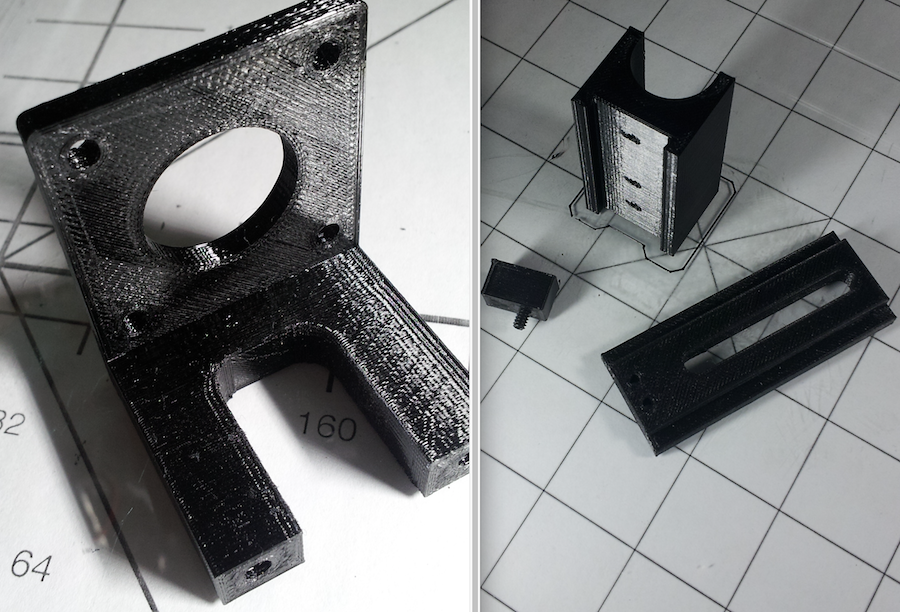

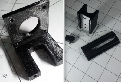

It took a bit of work to get good PETG prints but, I finally got there.
Both of my printers are Prusa (built from kits and modified for V6 hot-ends / etc)
No more stringing, blobs…etc.
Several print parameters dialed-in. If you review the attached files and tweak your printing, you may get good/similar results.
Part for testing the stringing/etc are attached. It represents the most difficult aspects of printing with PETG that I found to be bothersome (I designed them specifically for testing PETG on my machines with PETG)

The process I posted eliminates all stringing on my machines. But, 'yes', it's the biggest challenge so the parts I posted are good example to work with.
Tip! Lower the Hot-End Temp, check the print speed and, MUST use the fan - petg wants to be cooled as soon as it's laid down...
