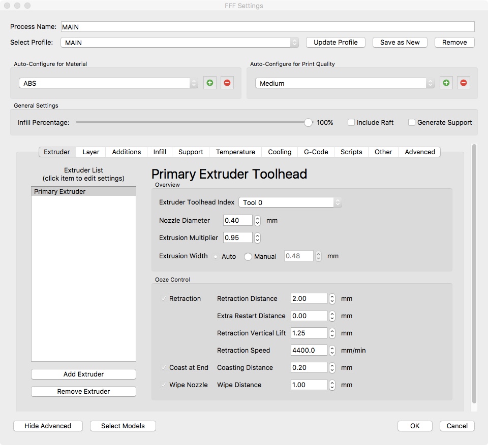

Anyway I've got a print here but I'm getting some gaps in the floor of the print where the outline meets the floor - they are tiny but recently I'm having problems with watertight prints. This is an Herb Garden which needs to be water tight.
I'm printing 4 top and bottom layers and 4 outline layers. Here is what i've tried moving each value up and down by its self and seeing if it made a difference. At no time did I adjust more than one value.
-extrusion multiplier
-filament width
-nozzle diameter (I found the gaps got smaller the smaller my nozzle dia but never disappeared)
-overlap %
Any ideas how to make these gaps go away?
