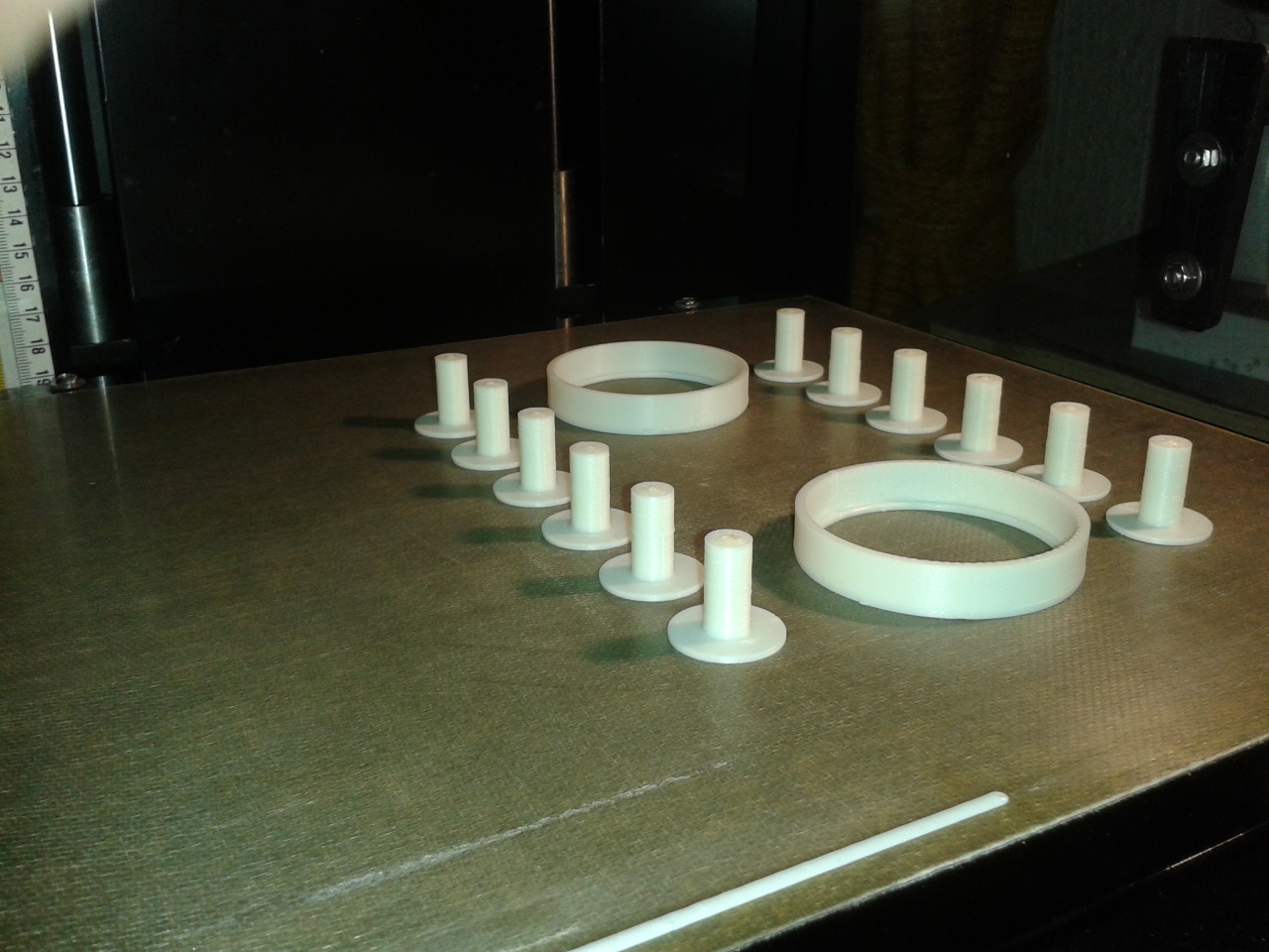

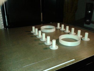

The last print of this day: (12 small towers to test glueing of the material -ASA-)

That is a typical "One-side" - "Other-side"-problem.
First it needs to print as slow as possible and do cooling (PLA) as fast as the fan can blow.
But the other side is that the nozzel is going around over a very, very small area and the print of the 2 needles is so quick one after the other, that the extruded material has no chance to cool down and becoming hard. That happens also with only 5% speed of your 40 mm/s. The next layer to print brings new, very hot, melted material to a warm and soft underground and the nozzle will press down the top . Thats the begining of your "onion" on the top of the needle (+ extremely over-extrusion). PLA has a soft-point-temperature of 60 - 70 °C. To become it hard, you must cool down more than 100 °.
The best way to solve this problem is a second print of anything far away on the print bed to win time.
