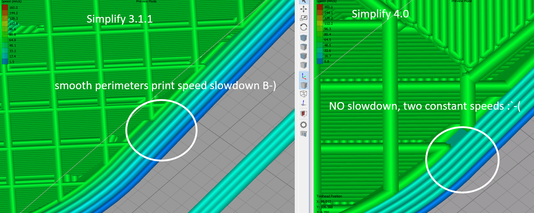

Simplify3D 4.0 update is very cool, but it hit me hard in one place.
in S3D 3.1 you can print internal perimeters on high speed, while external perimeter will be printed slower, and additional internal perimeters speed is slowing down line by line. It is very nice trick, as it allow to print more accurate surfaces with higher speeds.
But in S3D 4.0 there are only two speeds - one internal perimeters speed (slower than expected), for all internal lines/shells, and another slow external line/shell speed. No slowdown gradient.
Is it possible to get this smooth slowdown back, probably as an option? Like:
[v] Reduce the perimeters printing speed gradually.

> With v4 you will have speeds of 40 - 60 - 60 (starting from the outside).
Actually, 40-50-50 - internal perimeters print speed is not max speed. You can see the difference on the image above.
