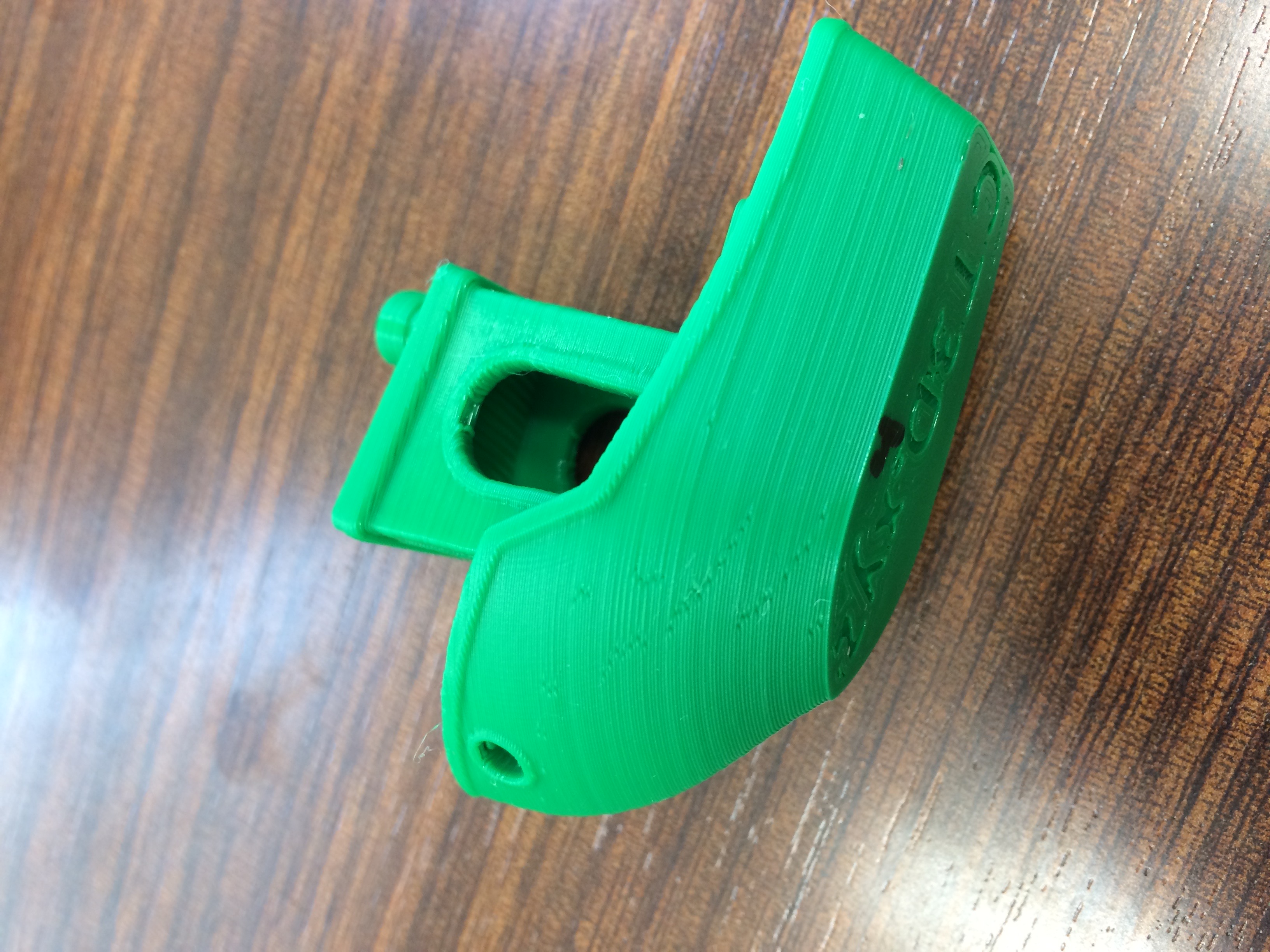

I'm using a Prusa i3 MK2S, and I'm dialing in my settings. I've been changing several different variables, in order to try to get rid of some surface defects (see the hull on my 3D Benchy below):
Here's what I think is happening. The printer completes the outline, pauses for a split second, and then raises up to the next z-height, and starts printing again. I've tried changing several settings, and nothing seems to make a difference. I've tried messing with coasting, negative extra restart distances, force retraction. Is there anything obvious that I'm missing?
I know that I can usually hide these issue in a corner, or on the back side of the part, but I would really like to get this fixed. My Printrbot Simple Metal doesn't produce these artifacts, so I know something off on my Prusa.
